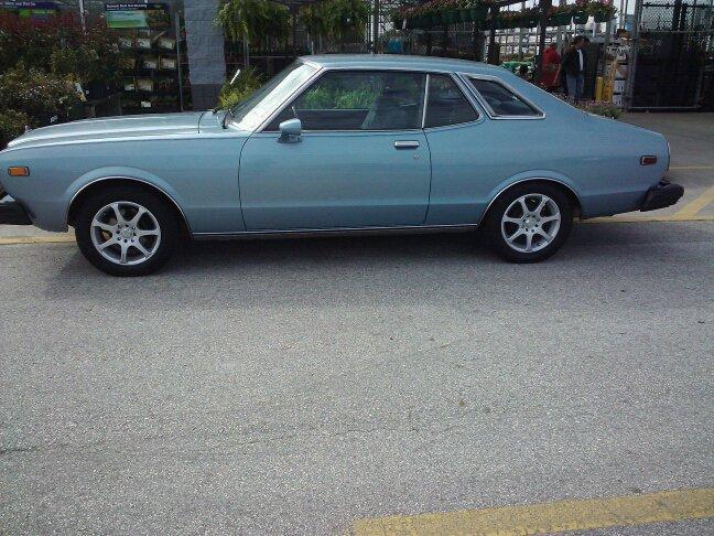

We have a 1979 Datsun 810 2 Door Coupe and are in need of fronts struts and rear shocks. We live in Houston, Texas and have had no luck. Any suggestions that will not break our piggy bank?
Thank you.
Here is a picture of the 1979 Datsun 810 2 Door Coupe. We have since added some rims/tires, and other items. The vehicle runs great and only has a little over 88,000 original miles!
We just need to replace the struts and shocks, but haven't had much luck finding parts.
Any suggestions would be welcomed.
Thank you.

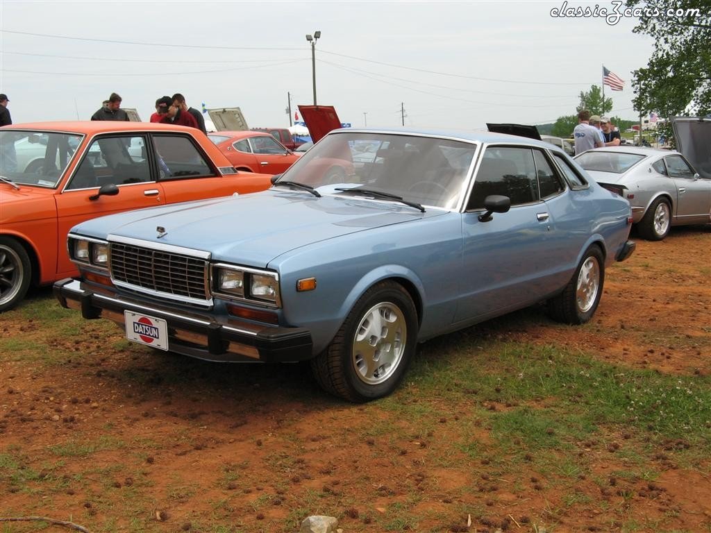

Attached is a photo of my 810:
