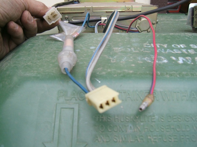

Okay, had some time to dig into this today. My initial goal was to swap out the heater control panels, but I figured since the radio would then be accessible I'd at least ask the question at the beginning of this thread. At the time, I did not have the radios right there in front of me, but after removing heater panels I went ahead and pulled the radios as well.
E, you were correct. The antenna, speakers and power, and antenna motor connectors for the AM-FM should have been exactly the same as the '71 AM seeking radio. The first photo shows the power antenna connector in hand, the thin 3 spade in the foreground, and the red w/ blue bullet that connects to a blue power lead, if my memory serves me correctly.

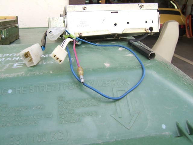

Unfortunately, my radio and harness were hacked when the previous owner installed an aftermarket sound system, so this wasn't plug & play. The second photo shows the power antenna was the same, and the red w/ blue bullet was also the same. However, the 3 connector thin spade had the blue wire lopped off right at the connector, and later added back in to retrofit the radio into the hacked harness.
In the end, I elected to stick with the AM radio while keeping an eye out for a unmolested dash harness from a manual car with a late '70 build date.

The unhacked wiring shows an in-line fuse holder. Take note that the "fuse" is NOT a fuse. It is a NOISE SUPPRESSOR for the AM band, over and above the condenser at the distributor and alternator.
If you really wanted to swap the AM/FM into the car, removing the second half of the Noise Suppressor holder and inserting it into the proper connector is really quite simple.
Use a very thin (both in thickness and width) straight edge screwdriver and insert it in the "hump" or "notch" visible at the connection side of the connector. That will lower the small tang on the top of the connector that locks it into place on the connector. Once that's done and before you remove the screwdriver blade, all you have to do is slide the spade connector out the back of the plastic housing.
Do the same on the remnant of the other wiring harness.
Insert into the proper connector and if you haven't mangled the tang, it will once again lock into place.
Presto, Zesto you've swapped the wiring out, and in the FWIW dept, if you're not looking for "Concours" matching interior, go the AM/FM route, you can at least find music on FM while AM is mostly talk radio.
