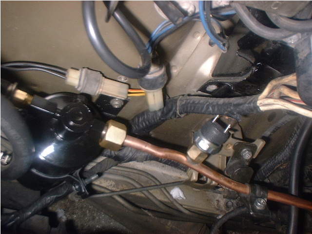

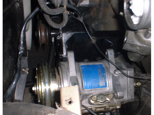

August 13, 201113 yr comment_363954 i believe the dryer was from a 79 and i used the pipe from the 79 that connects up to the pipe coming out of the firewall. the 79 pipe i had to shape a tad to make it connect up to the dryer. you will notice that the low pressure switch is not located on the dryer where the 78 and earlier switch is located. i took off the stock nissan low pressure cut out switch thats in this photo and put in an aftermarket dual high/low cut out switch. i also had to saw off the mounting tabs on the dryer so that it would fit inside the 78 dryer mount. z31 compressor z31 hose end used to make new hoses aftermarket parallel condenser in hawaii i like to run the a/c year round. i've also installed a junkyard pusher fan. you should be able to still get the original 78 though. black dragon has them for 49 bucks. http://www.blackdragonauto.com/icatalog/zr/full.aspx?Page=28 Edited August 13, 201113 yr by hr369 Link to comment https://www.classiczcars.com/forums/topic/36744-ac-expansion-valve-repair-and-setting/?&page=3#findComment-363954 Share on other sites More sharing options...
