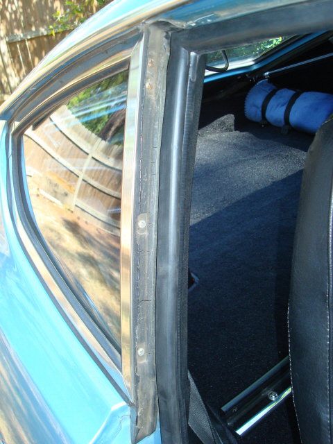

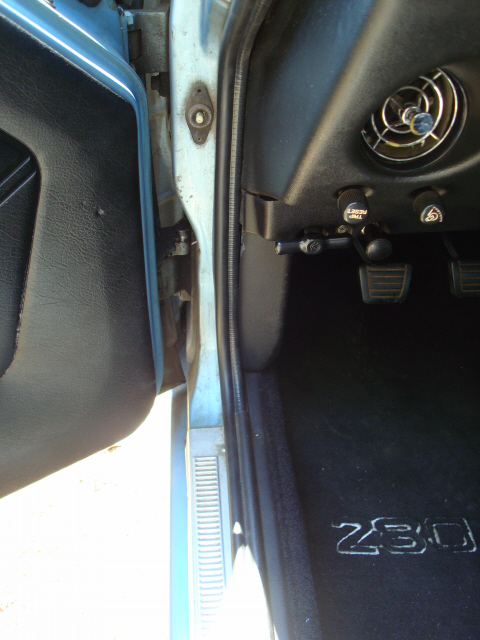

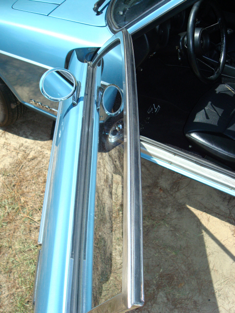

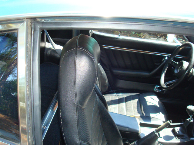

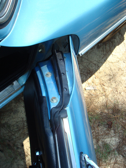

Finally got the time to replace the door and body side weather strip on my '77 280Z. Fit was very good, the usual hard to close and open door, not making a show car so i am happy. Now those quarter windows, looked in the Wickes book, it does not show what the seal looks like on the quarter window installed on a car, just the parts breakdown. Can the damaged seal be replaced without removing the window? Everything i have tried to fix no mater how careful i am, something else breaks.
Edited by kjphilippona
Rather late in this thread, but FAIW, I had to replace the door strips on my first 280Z when the car was only 8 years old. (It was a harsh environment.) I bought the stripping from my local Nissan dealer. It cost $$$, but it was genuine Nissan, and it was still fairly new rubber. When I was done, I recall it being harder to close my doors (with the new, genuine Nissan stripping) than when I finished replacing the stripping on my current Z with BD's stripping (only yesterday). Moreover, the fit is easing up much faster on my current Z with BD stripping than on my old Z with Nissan stripping. Anyway, I think a tight fit is just the nature of the beast.
FAIW, I'm generally of the opinion that old, genuine Nissan rubber is still old rubber. I prefer new aftermarket rubber wherever possible.
