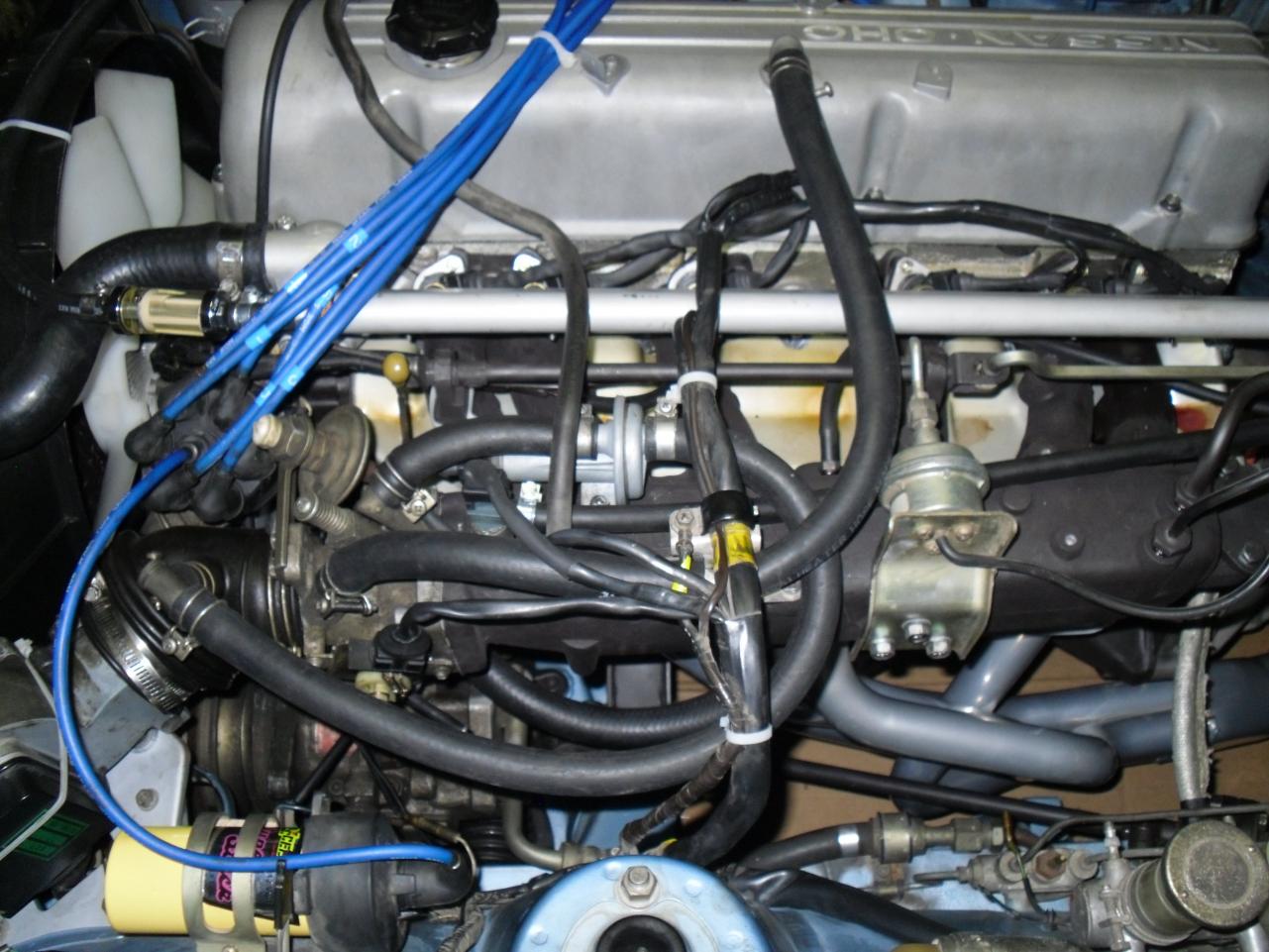

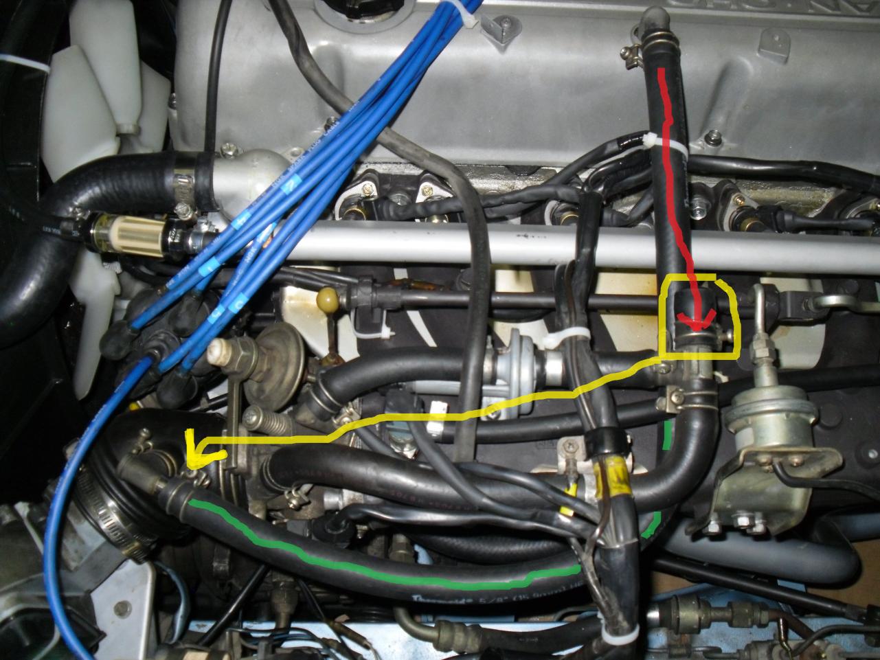

I changed my hoses to the '78 configuration too, it keeps the AAR cleaner.
