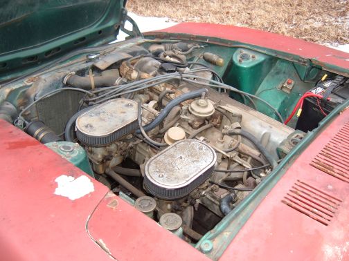

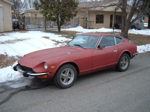

Finally got some pictures of my sons car today. 74 260 He didn't drive it to school:surprised So I took it to town and got a new batt cable- after it wouldn't start at the autoparts store until we wiggled the cable.
We got the car for 450 and have about 1200 in it now. New exhaust from the resonator back, new starter,2 new tires, some new hoses, 5 speed trans. new driveline, dang non servicaable ujoints no more. I like driving it. It's a little drafty and it clunks when you decelerate like something is hitting the underside of the car in back but it is fun to drive. The trans. is shifting nice. It drops the rpm about 400 It is 2800 @ 70 if the speedo is correct. We used the Black I think speedo gear from his old 4 speed.
Need to figure out the clunk next and source some weatherstripping etc.

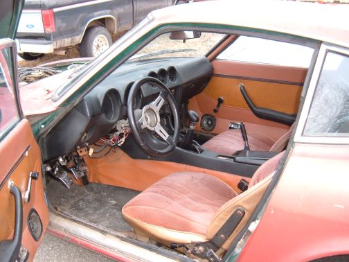

And I need to check out the timing and how to sync the carbs, Webers I think. Plus somebody has screwed with the wiring at the column:rolleyes:

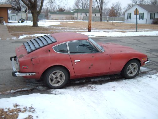

Are those bullet holes in the passenger door? :)
Edited by =Enigma=
Looks like you've got the answer to the 'clunk'. For weatherstripping you can check out Blackdragon or Motorsport Auto (MSA). Both of those companys use rubber made by Precision Replacement Parts or PRP.com. They offer a complete kit for the car. If you are interested in carpet and seat covers, both Blackdragon and MSA have good selections and pretty nice quality.
No just rust . This car must have five layers of paint and it is coming off in quite a few spots. It needs the full resto but I don't have the money and, it is my sons car and he is going in the army in may so maybe I'll store it/ drive it:) till he gets out and has money. We do hope to get it to a friends shop soon and deal with some of the bad spots though.
