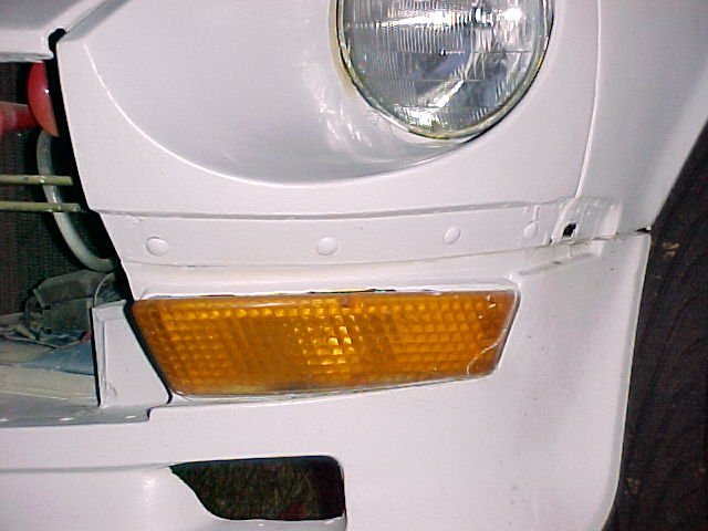

I want an Air Dam! But I don't wany to glass it into place.
What I'd like is a fiberglass model that replaces the sheet metal piece, using the same mounting bolt locactions.
I like this style in particular. Any suggestions?
