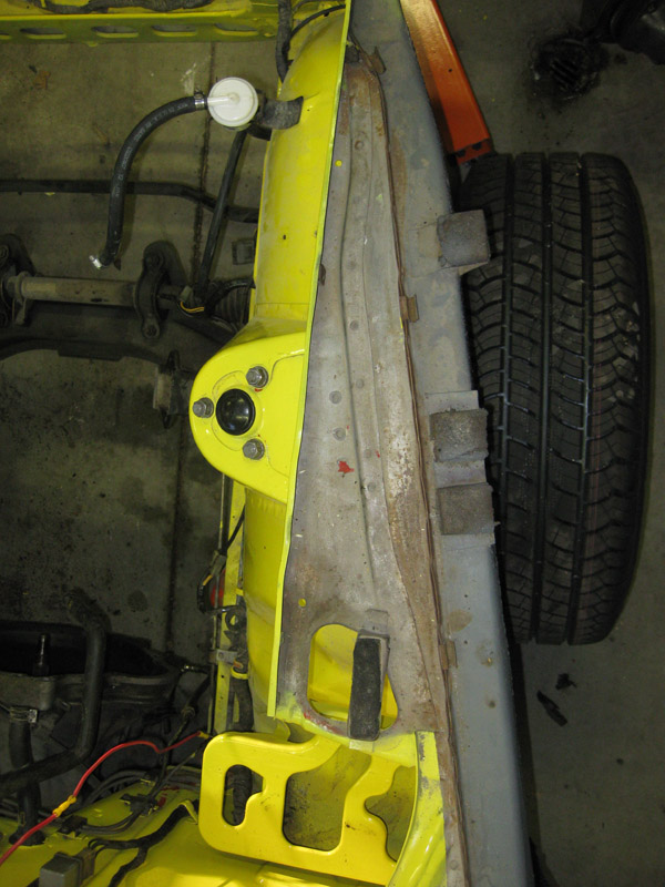

I've heard people say that I should go to Home Depot and buy their weathership material for some of the foam-like strips under my front fender. I did buy the MSA inner to outer fender weatherstrip pieces.
What about those square pieces on the top of the inner fender. Any recommendations? What's there now (see picture) has crumbled to dust.

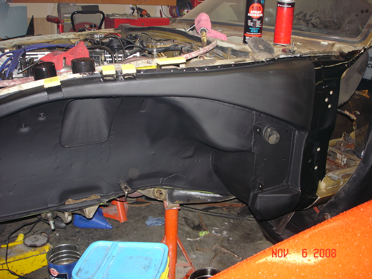

I personally went to the store and bought one of those 1/2" thick foam soda can insolators. You can pick them up at your local craft store like I did.
Anyways, it's a soft yet thick foam (Neoprene I think) so I just made a slice down one side and cut the bottom off. Cut the peices to fit and glue them on. It'll last WAY longer than the desintegrating foam that WAS on there.
I attached a picture that you can kinda see what I'm talking about. You'll never see them again so color doesn't matter.
