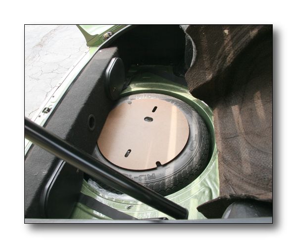

On the '75 there's a circular (dish shaped) hardboard cover over the spare. Starting in '77 they put in a larger tank, made the spare tire depression shallower, used a space saver spare that didn't save space, and raised the hatch floor with a hardboard false floor. However, I think your carpet would have simply laid on the (metal) hatch floor, with the exception of the hardboard covering the tire.
Now that you mentioned it, there is a circular board the previous owner shipped with the car. I didn't know what it was.
So, I guess the circular board is the only thing that covers the spare tire and the carpet will just go over the metal trunk area.
Thanks for your help.
Here is a picture of what is in my car it's a 11/75 build and purchased in Feb of 1976. I am the original owner so it is original.
The spare tire is kind of useless since you need to pump it up before use in the middle of nowhere:bulb:
Im going to make a compartment out of the well a door that hinges up to reveal battery relocation or something :paranoid:
That's what the can of air is for. Your relocated battery won't do you any good at that point if what you actually need is a spare tire......
