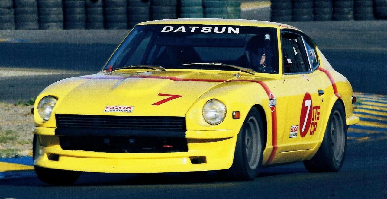

Got back recently from an SCCA double at Infineon. I drove like a turd to include a huge spin entering turn 10 without hitting anything. Still fought back for a second. The car that won, a BMW 325, got protested prior to the next race. Rumor has it(from very reliable sources) that he has a 3+ liter engine in there amongst other stuff. Any way, he refused the tear down and left the track, taking with him a 6 month suspension and $250 fine. Kinda puts a hmmmm on all the wins and track records he's been earning lately. My wife told me to knock off the spins and to take it easy for the next race. :rolleyes: Of course I did and got a solid if uninspired win behind an ITA Miata driven by former national champion Mark Hoover. Yea, I know, a Miata. But hey, my car is in one piece and I can now cruise the winter months doing improvements! Thanks to those of you who gave me direction and support.
