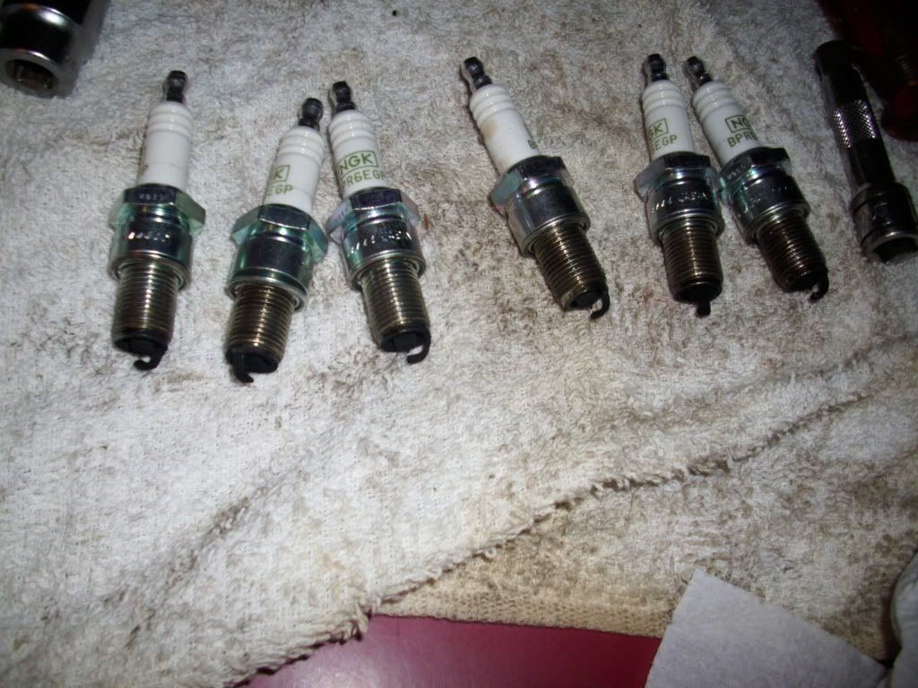

August 8, 200915 yr comment_291434 the plugs are carbon fouled you are too rich. it could be stumbling do to the fact when you lift the piston you are dumping even more fuel in there boggin it down. Turn them in all the way and back out 2 or 2 1/2 I do 2 and work from there but i am only 600 feet above sea level. What i do when i tune is leave 4 old plugs in that are still good and only put 2 new ones in so i am not trashing whole sets at a time. YOu are barely supposed to lift that piston too. Like a **** hair. Anymore will give false results Edited August 8, 200915 yr by yetterben Link to comment https://www.classiczcars.com/forums/topic/32733-rough-idle-video/?&page=2#findComment-291434 Share on other sites More sharing options...

August 8, 200915 yr comment_291440 A hotter spark would help as well , but you're nearly there it seems ! Like the pics, a thousand words . Link to comment https://www.classiczcars.com/forums/topic/32733-rough-idle-video/?&page=2#findComment-291440 Share on other sites More sharing options...
August 9, 200915 yr Author comment_291512 Well I think I've got it running at a decent state now. The odd thing is that all the plugs are carbon fouled, making be believe it is running rich, yet when I lift the piston ever so slightly, the engine stumbles, which is supposed to mean it's running lean?ehh whatever. Today I got a thrust welded muffler, put it on backwards, because it won't really fit the other way haha (does that screw up the muffling?). It's quieted to a bearable level, but still pretty loud. I did a hot compression test.dry1 - 1752 - 1753 - 1704 - 1705 - 1756 - 175wet1 - 1752 - 1753 - 1754 - 1755 - 1756 - 180Oh and now all the doors lock!! woohoo! (driver door was sagging) Link to comment https://www.classiczcars.com/forums/topic/32733-rough-idle-video/?&page=2#findComment-291512 Share on other sites More sharing options...
