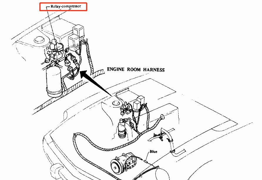

The switch contacts in the AC relay have been “welded” closed. You can replace it or remove the cover from the relay and clean the switch contacts. Common problem. I have been putting a 0.1uF film capacitor across the points. This will reduce the arcing which creates the welding.

The AC relay is not located under the dash. It is located on the small AC bracket with also holds the vacuum switches and the check valve.

I can’t understand why you are putting off a repair that will take 10 minutes to fix? And, BTW, the easiest way to disengage the compressor clutch is to simply unplug the blue wire going to it!
