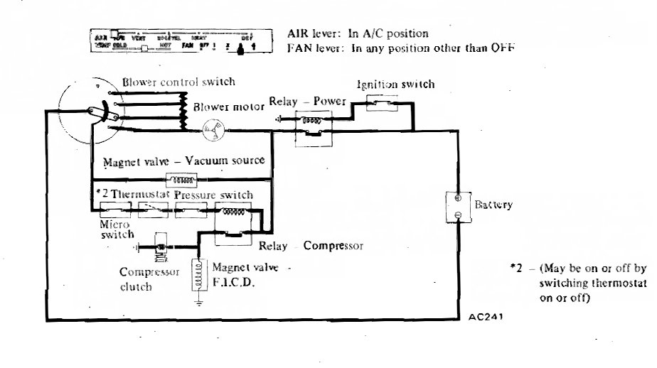

The clutch clicks on and off when you applied voltage from the battery but it doesn't when you turn the switch from inside the car. Start at the compressor and work your way back towards the switch inside the car trying to find out where the voltage is going.

It is the AC relay (located on the small AC bracket with also holds the vacuum switches and the check valve) that energizes the compressor clutch through its switch contacts. The AC relay coil, in turn, has three switches in series with it: the under pressure switch (located on the receiver/drier); the ON micro-switch (energized by the AC control lever on the console); and the thermostat switch (located behind the temperature control lever). In addition the blower switch is also part of the circuit since the blower fan must be on while the AC is running (to prevent excessive pressures in the AC system). So, there are several items that must be checked to verify the series circuit is complete.
Check the easiest-to-get-to items first: The AC relay and the under pressure switch. The AC relay can be checked for both switch continuity and whether or not the coil has voltage across it. If it is suspected then it can be substituted with a good working one. The AC relay can be taken apart to inspect the contacts for pitting (very common since you are switching an inductive load) and the contact points can be cleaned with a points file.
The under pressure switch is screwed into the top of the receiver/drier. It can be tested with an ohmmeter after it is unplugged or you can short it out with a jumper wire to check it. The under pressure switch is available separately from Nissan, but it requires you to discharge the AC system first before replacing it.
The micro-switch and thermostat switch can be tested after you remove the control panel on the located between the console and the dash. Again, use a jumper wire or an ohmmeter to check them. I’m not sure about the availability of NOS parts as I have never seen these parts become defective (fortunately). Since your blower fan switch seems to be working (based on your post) I would assume that your blower switch is OK.

With the car off and the leads disconnected, I put my multimeter on the under pressure switch and it failed a continuity test. So there's my problem.
