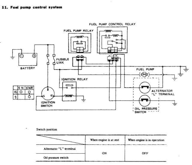

According to the wiring diagrams, when you key on, you should see 12 volts to the EFI Main Relay and Fuel Pump Control Relay. The control relay gets input signal from the alternator and/or oil pressure switch after the engine is running. It looks like the Control Relay actuates the Fuel Pump Relay. Diagnosis will be much easier if you have a test light or multimeter. The ignition relay should also click when you key to what looks like 'on' or acc. If I follow the decision tree, simply keying 'on' with the engine off will not run the pump like many newer cars.
Here's the service manual
http://xenons30.com/reference.html
You'll find fuel pump troubleshooting and diag on EF-35. The png I attached is from page EF-16

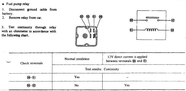

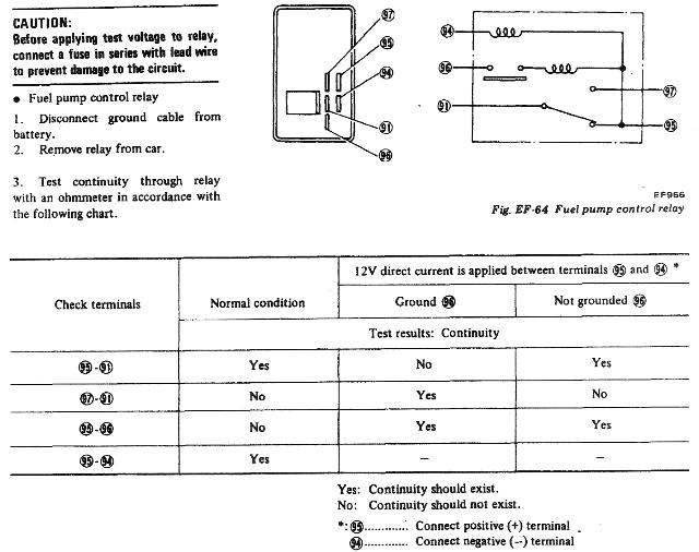

I've never done electrical testing. I watched it being done a couple years ago for an AC but that's about it. So I am not sure how to do the continuity test. I have a multimeter I can use and the FSM.
You've got a good start, you know the pump runs and the battery ok.
Remember electricity follows a path from positive to negative. When the path is broken, the circuit is open and electricity will not flow. Probing for voltage 'backwards' won't harm the meter or do anything bad... it just reads a negative voltage. Check voltage by checking the terminal to ground, not across the relay. In other words, place the red probe on the terminal and the black probe to ground (negative battery terminal or suitable engine/body ground)
Continuity is continuous or connected from point A to point B. If it has continuity, the meter will usually beep. Using sblake01's middle scan, placing one probe on pin 91 and the other probe on pin 95 should produce a beep from the meter, or 0 ohms resistance.
btw, those are great scans from sblake, I'd check all three of those. Good luck!
