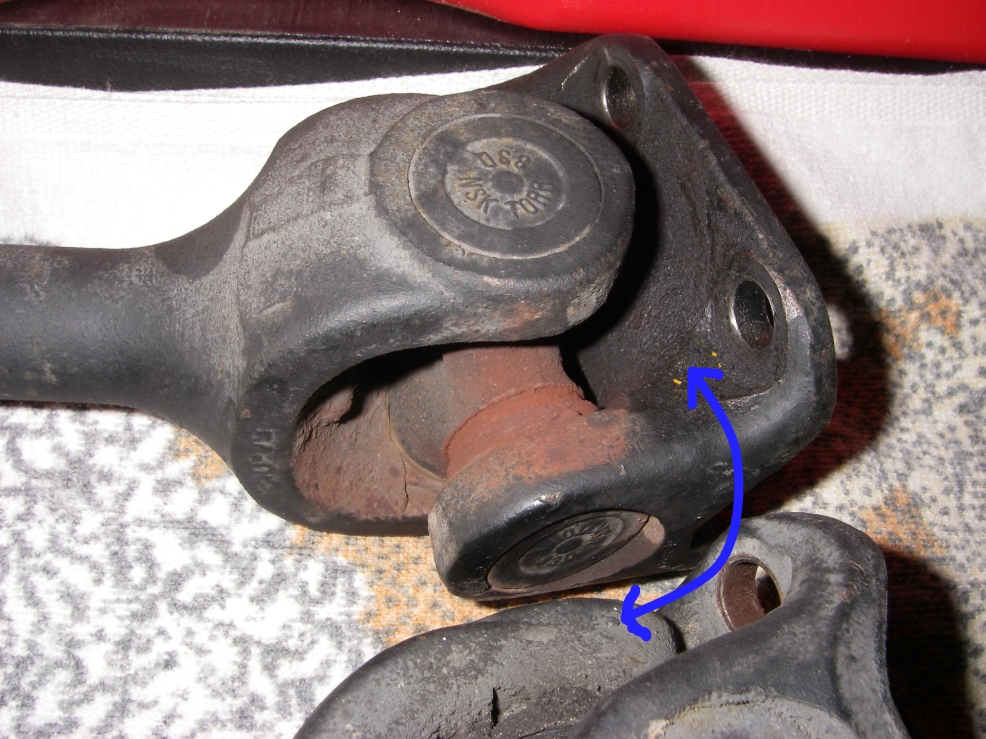

So I ordered a full set of u-joints from MSA about a month ago. Finally had the free time to tackle this issue.
Here's what I found after pulling the driver's side halfshaft:
This joint was toatlly dry and rusted on two sides. It really didn't want to rotate in the direction of the arrow.
So I'm taking both halfshafts into "Driveline Services of Bellingham" tomorrow and he's pressing in my new joints for about $60.
