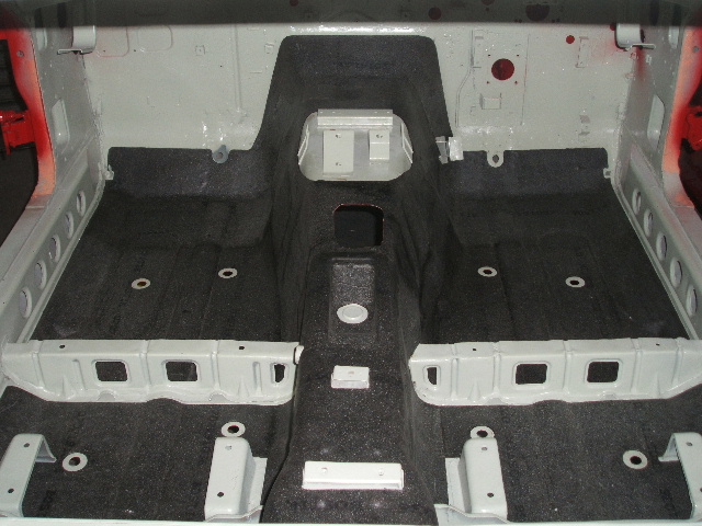

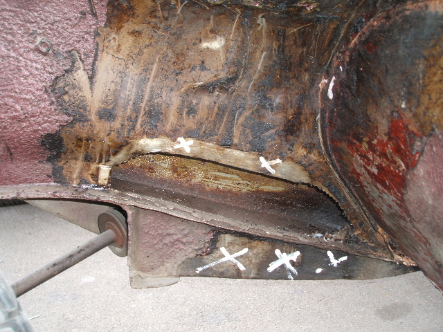

Here are a couple of photos given to me by a club member when I replaced the same section plus pic's of mine.
When I did the repair the picture came from I used 16 ga. and doubled it up to match the original configuration. I did not want to collapse that part of the frame if I ever hit something with the front suspension. The torsion rods connect just in front of that repair.
