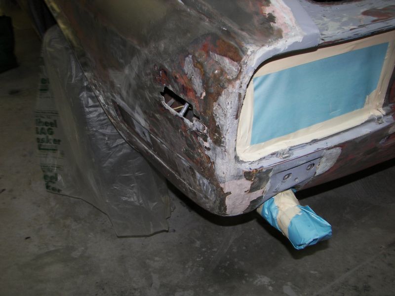

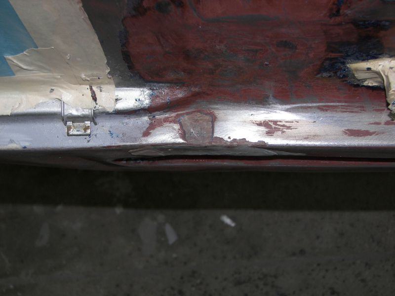

I went out today to check on the paint and body progress on Larry's car.
The paint was chemically stripped to about 70% clean so as to show the type and quality of metal repair Al did in his restoration of the car.
What was found was:

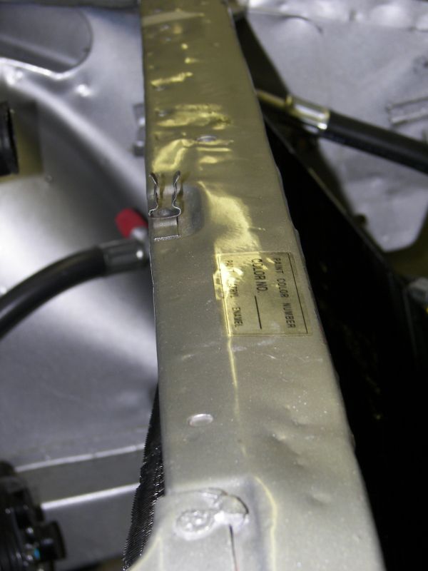

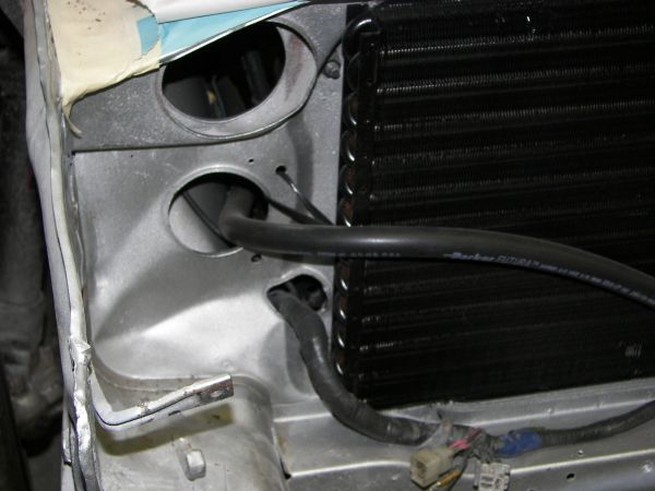

1) More mismatched, un-restored, hardware-store fasteners securing everything-the Air conditioner condenser was held on with just two zip ties.
2) A healthy amount of dent repair was done with filler on top of two or more layers of paint-1/8" in places-indicating that the only attempt at sheet metal repair was to call for less filler, and not to correct the shape of the metal.
3) In many of the places where the layers of old paint were ground off, the metal was allowed to sit uncovered long enough to "brown" from exposure, and veins of rust had already started under the filler.

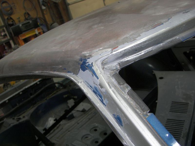

4) As illustrated earlier, the car had been hit front and rear, under the filler at the roof seam at the passenger side quarter window was one of six kinks in the chassis caused by front and rear impact. The passenger side measures almost one inch shorter than the drivers side, explaining the fact AL could not get the front bumper to bolt up on that side no matter how much he tweaked it. The Kinks also explained the torn spot welds on the core support. One thing I did not catch was the fact that the repair to the rear of the car was so poor that the taillight panel is actually leaning inward-explaining the voids at its attachment to the rear floor, and the buckling in the spare well and on either side of it in the rear floor-the rear panel was manipulated under pressure and welded in to fit, the area was not trammed correctly then the panel replaced after properly fitting it to the cut out area.

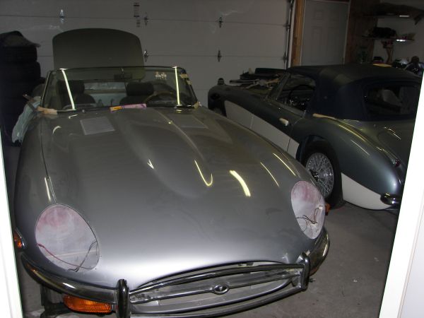

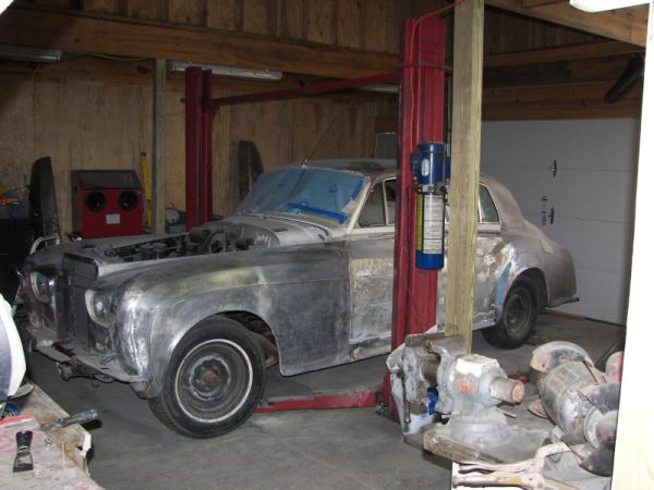

Currently in the Spa with Larrys 240Z are a big Healey, a series 1 Jag XKE, and a Ferarri Testarossa, when I dropped the car off last week, there was a Rolls Royce Silver Cloud, An Aston Marton DB9, and some American muscle.

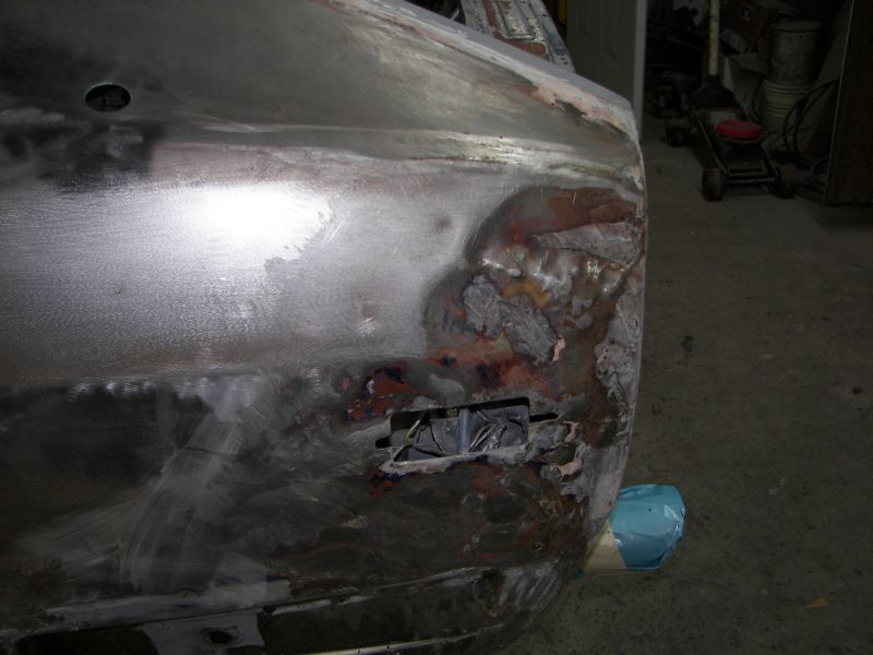

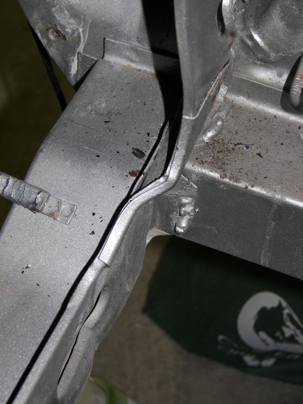

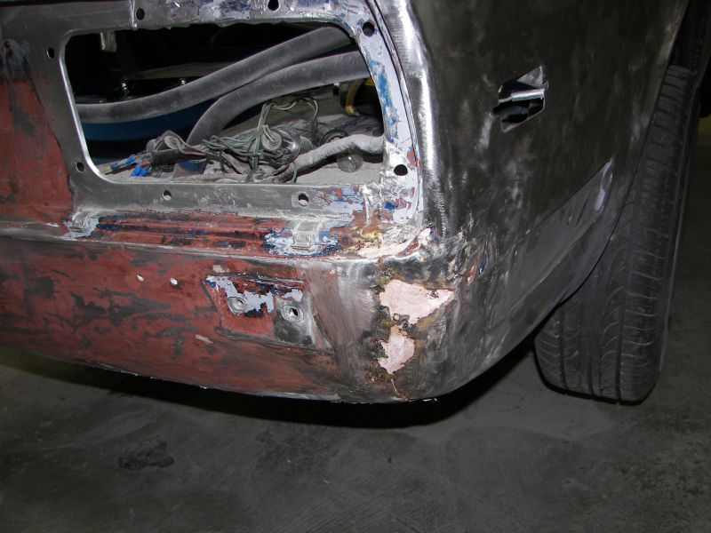

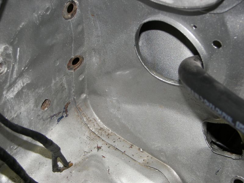

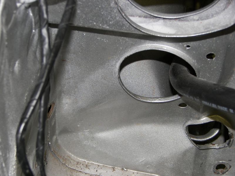

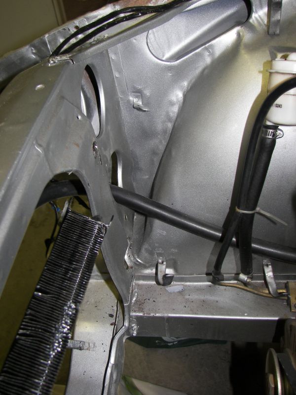

More details...

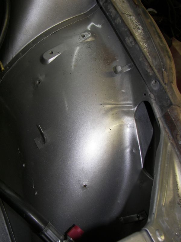

The floor rear floor between the taillights and the riser behind the seats is seriously tweaked. There is not one level spot in it. The tirewell is not round, or level, as pointed out before the rear floor beside the tire well is bent upward on both sides, the floor in front of the tirewell is bowed up, what I originally thought were shrinkage cracks in the sound deadening have turned out to be stress cracks. The curve at the rear of the car is 1/2" inward from where it should be at the center of the panel-and it is all in the rear floor.
The car will be trammed as per the Nissan Restoration Checklist over the next week, and I will get pictures with a straitedge across the area to show how distorted it is.

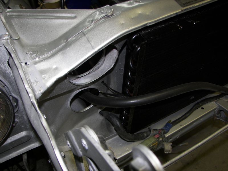

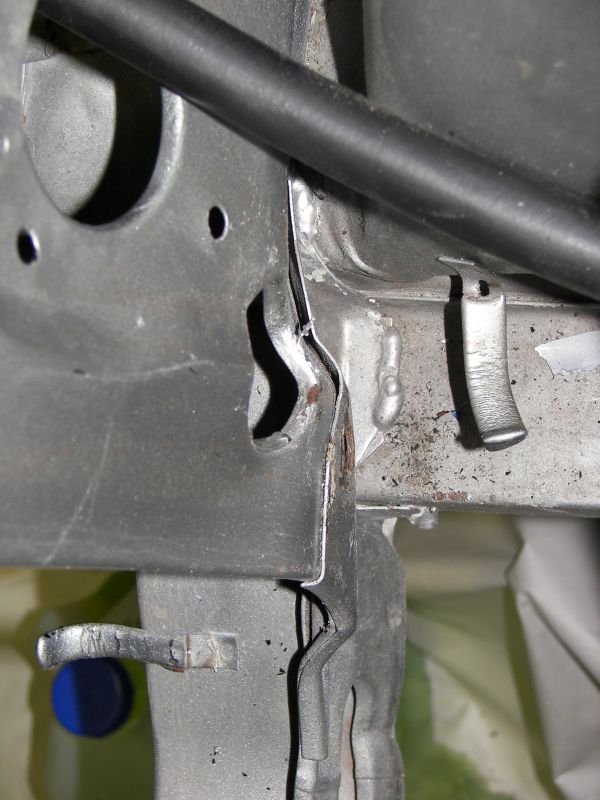

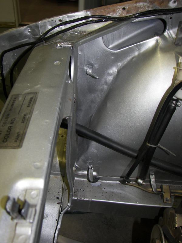

In the meantime here are some more pictures of other impact damaged areas.
Edited by hls30.com

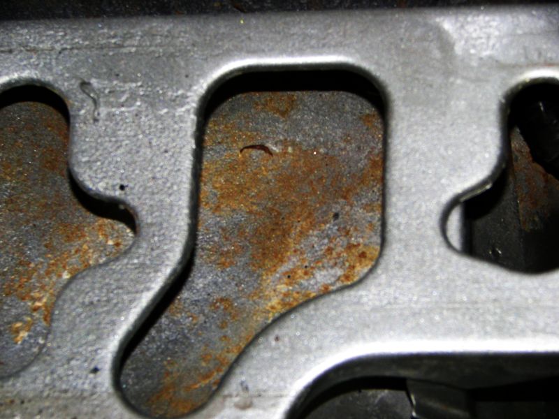

And a few more...

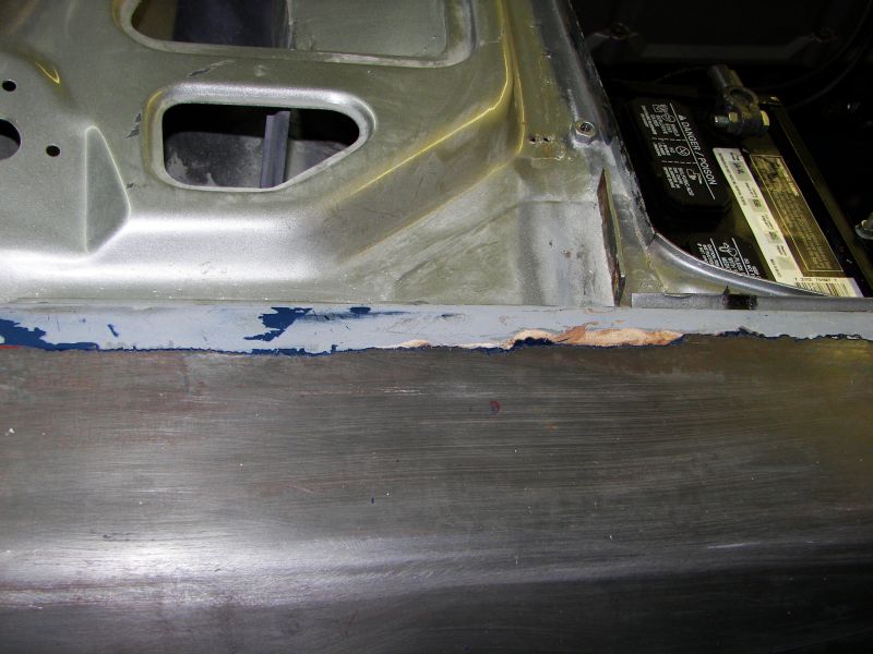

Notes:

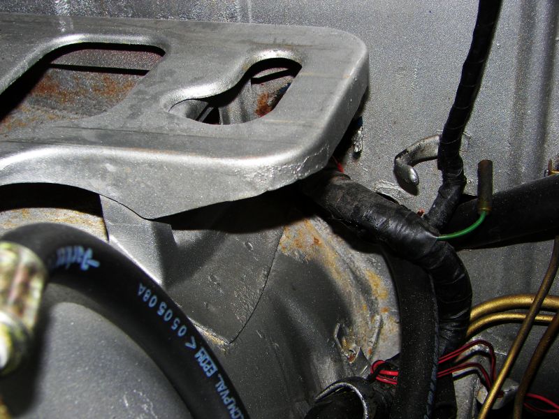

1) Rust in battery area-not treated-just painted over, and coming back-even though the car has not been stored outside since it came to the low country.
2) The body steel extending down the hatch is 1/2" lower than the hatch-built up with filler.
3) A dallop of filler in the top corner of the windshield channel?
4) No attempt to bump any of the metal close to the right shape-every panel(except the roof) has shallow dents that will be worked out instead of filled.
5) more than 1" of filler in several places
6) The car shows absolutely no evidence of any attempt at chassis straightening.

The final tally of sheet metal replacement is in, the hood, hatch, lower valence center panel, and passenger door will be replaced. Restoring them with metal bumping would cost more than replacing them.
There are problems with replacing the chassis. In Ca they may well be $500 and findable, but then there is the shipping to get it here. Plus there could be legal ramifications later.

Leave it to me to say everything was pretty much done. The DS dog leg was repaired by bashing it in, closing it up with fiberglass, and filling the void with filler-visualize a baseball sized hole beaten in with a five pound hammer and rammed chock full of bog.. I am wondering where the reinforcement that should be under there is. I left the camera at home, and will post my cell pictures as soon as I find the cable.
Looks like the most cost effective repair will be to replace the entire rear clip.
