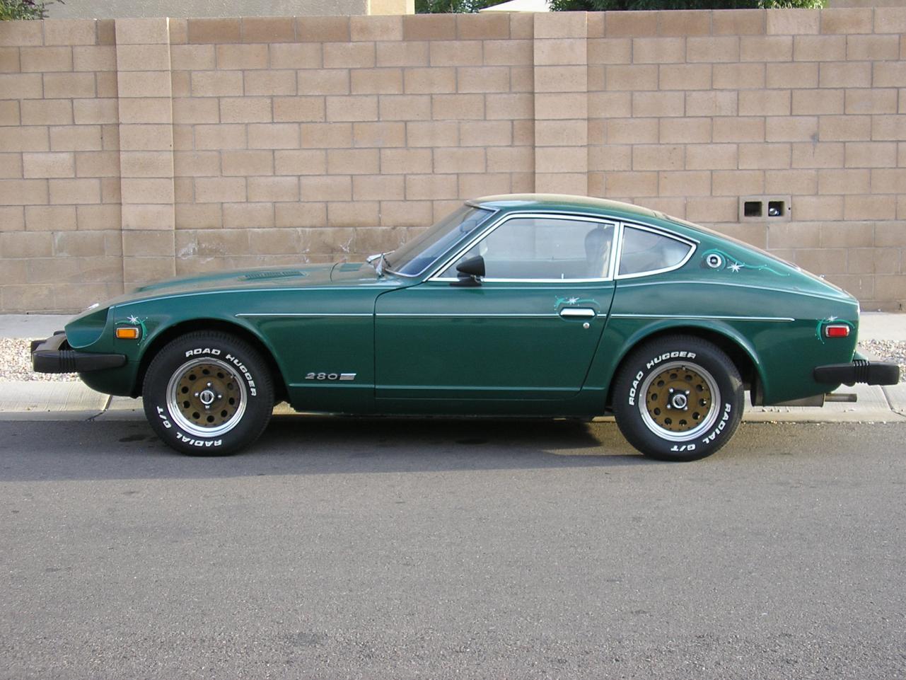

So, I recently purchased a 1978 280z here in Albuquerque. The car has 189,000 miles on it. The owner told me the car had only minor problems, but now that I've been looking at it closer I'm realizing the problems it has are huge! Was hoping to get a little advice from this forum to help me decide what to do with the car.
THe Good things this car has going for it are a very nice interior with freshly-done seats, new carpet, dash cover, etc. The exterior of the car is nice, with decent paint (1992 re-do but garage kept) nice wheels and tires. The owner recently installed some new injectors and had the clutch and brakes re-done. All electricals, switches, and gages work fine. All good stuff, right? Here's where it goes downhill.

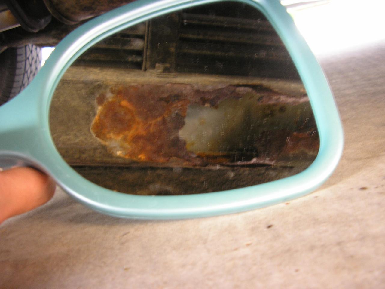

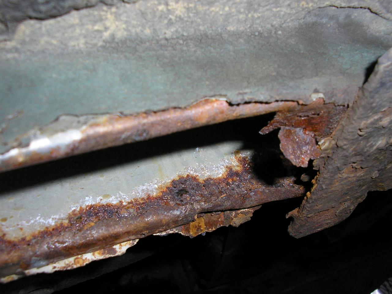

Now, the Ugly. What serously concerns me the most with this car are the rust problems I am just now discovering. Floor pans look like they *may* be able to be salvaged, I mean fixed somehow and not have to have new ones put in. Most of the underside of the car is covered in (what looks to be) 30-year-old undercoating material of some sort, but on the passengers side there is enough exposed to see what looks to be serious rust issues affecting the frame rail.

It sounds to me like you haven't done any paint/bodywork before. If you have the aptitude to learn these things it's doable. For someone who does this day in/out this sort of thing would be a two-three day turnaround. For someone like us it may take weeks or months. After doing my own pans and rail I was comfortable with it. Another member had me replace his pans over a day and a half.
If you have the equipment to fix it yourself and you're attched to the car I say keep it. The cost of having a shop do the work could easily buy another 280Z... or two or three.
I put in a frame rail on my Z and it wasn't difficult. The problem is having the garage space or work area to both store the parts and do your stripping/sandblasting. The engine, tranny and everything else are going to need to come out. Use Aircraft remover to strip the undercoating. Be careful not to get any in your eyes! Wear goggles and some full body protection. If it gets on your skin you will get chemical burns. The asphalt melt sheet (topside of pans) can be removed with a scraper and a heat gun or carefully used propane torch. (Use torch to warm not melt)
You'll need a decent MIG welder, compressor, sandblaster and paint equipment.
Might as well replace the pans or at least do a partial pan replacement. (I'm assuming the car is not for winning shows) You can use mild steel and fab your own pans if you can't afford the repro's.

This situation merely points out how easy and necessary it is to jack up a car and get under it and take a look when evaluating a purchase. That deterioration is way too obvious to be spotting it after the purchase.
What...you don't like the nice new ventilation ducts time and rust provided you???
Do some searches here for "gas fumes," "floorpans" and "clunk, rear end, diff mount". While the problems you describe here seem to you as major (and from a cost and "surprise factor" they are) what you have is a typical 30+ year old unrestored Z. Bottomless pit? Not really. But it's pretty deep, and without a good flashlight the bottom can seem waaaaay down there.
New floorpans plus install is around $800-1200, maybe less if you have a friend who welds.
