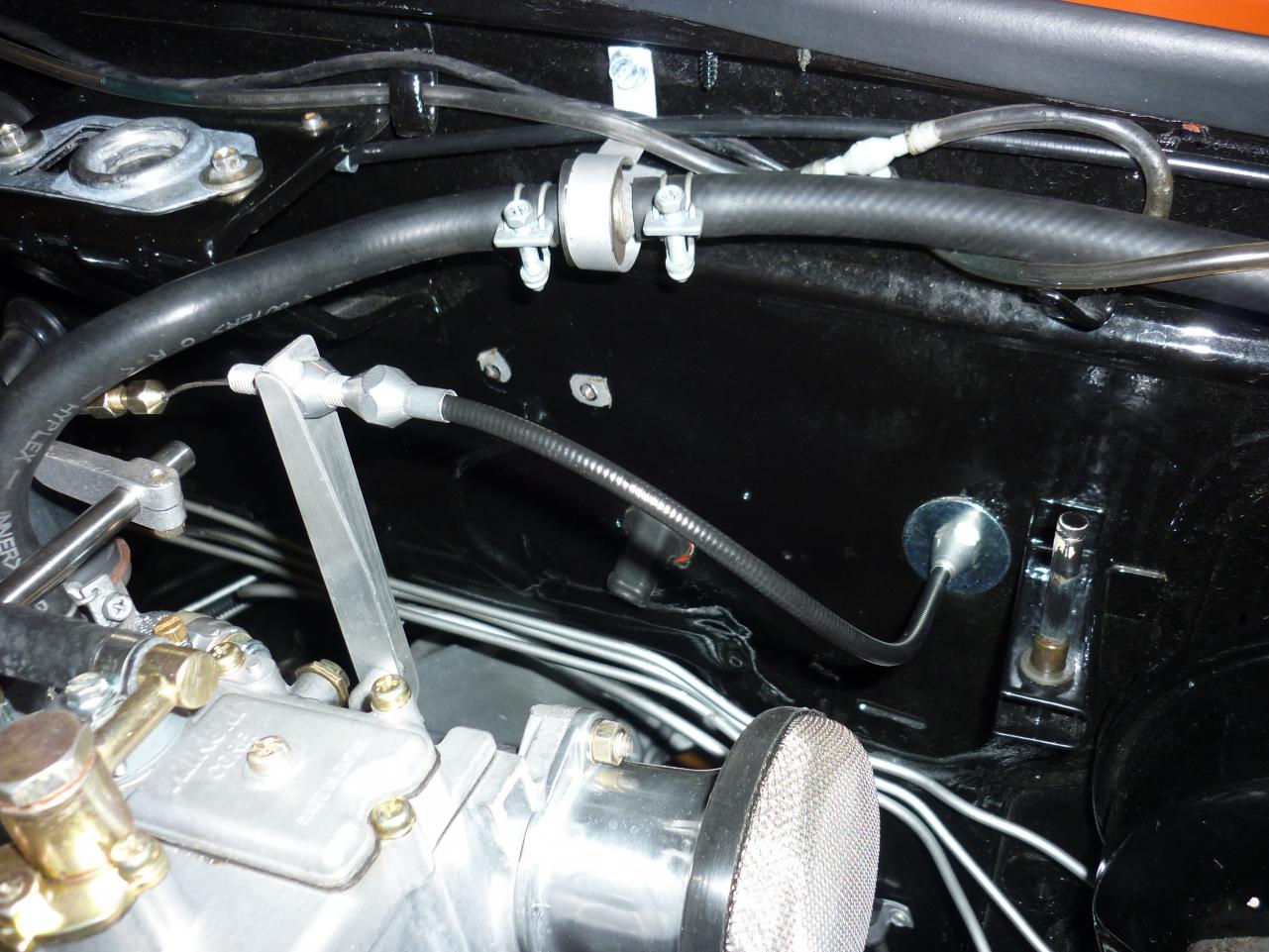

May 7, 201114 yr comment_355062 Lokar Kit installed Link to comment https://www.classiczcars.com/forums/topic/28117-accelerator-linkage-fix-questions/?&page=3#findComment-355062 Share on other sites More sharing options...
