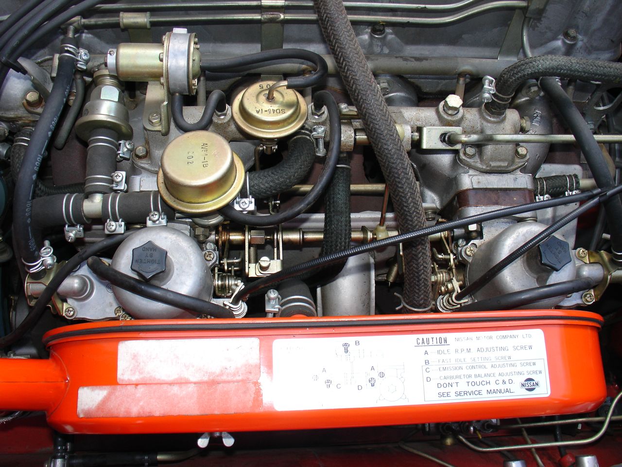

May 15, 200817 yr comment_247456 The broken part is the check valve for the air injection. The two empty fittings should connect to each other. The vacuum line to the distributor needs to be relocated to a small nipple on the front carb. The two capped off fittings on the balance tube need to connect to the emissions devices as shown in my attached picture. This will be a good first step, but I don't think it will cure all your problems. Link to comment https://www.classiczcars.com/forums/topic/28113-broken-fitting-performance-problems-trying-to-get-her-back-on-the-road/#findComment-247456 Share on other sites More sharing options...
May 15, 200817 yr Author comment_247457 The broken part is the check valve for the air injection. The two empty fittings should connect to each other. The vacuum line to the distributor needs to be relocated to a small nipple on the front carb. The two capped off fittings on the balance tube need to connect to the emissions devices as shown in my attached picture.This will be a good first step, but I don't think it will cure all your problems.THANKS! My first question is can I do any damage driving her like this? Next- does the check valve need to be immediately replaced for proper function- and is this a big issue? Is time or cost a major thing? I'm not sure how long it's been broken. Some people apparently believe that some parts can be disabled for whatever cause...is there any reasonable purpose for those lines to be intentionally pulled off? Except for the well known fuse block issues and the horrible gas tank vent hose psychotic design, I assume that the engineers knew best when they designed the car- so I believe that everything should be connected as delivered- unless there is a tried & tested reason otherwise- do you agree?You have a beautiful engine bay! Thanks again. Link to comment https://www.classiczcars.com/forums/topic/28113-broken-fitting-performance-problems-trying-to-get-her-back-on-the-road/#findComment-247457 Share on other sites More sharing options...
May 15, 200817 yr comment_247483 All of those items are strictly emissions items. I don't believe that any of the current issues could damage the car. Back in the '70s had I owned one, I'd probably have disconnected all that stuff right away. These days - being both a bit more realistic, and more environmentally aware - I see no good reason not to have it all connected and functioning. The air injection system used on the 240Z has virtually no effect on performance, other than the parasitic drag of the belt-driven air pump (mounted below the distributor).That said, if your air pump is already disconnected, bad or missing, I see no reason to worry about this stuff. Assuming, of course, that the car is emissions-exempt in your state.If it were me, I would move the vacuum line to the distributor to the proper port on the front carb, on the remote chance that the amount of vacuum coming from the balance tube (where it is now connected) is not the same as that from the front carb. If you do this, make sure to cap the nipple on the balance tube where you move the line from. Link to comment https://www.classiczcars.com/forums/topic/28113-broken-fitting-performance-problems-trying-to-get-her-back-on-the-road/#findComment-247483 Share on other sites More sharing options...
