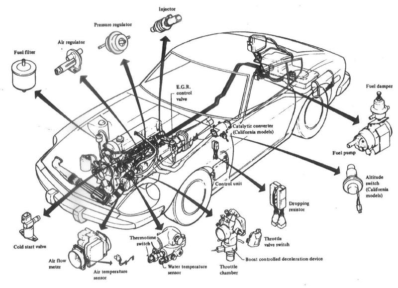

Between the AFM and the TB there is only one hose, on the top. It runs to something on top of the intake manifold. If someone has a picture of the BCDD, as I can not find it on my tech drawings of the motor, I would appreciate it.

The BCDD is on the bottom of the throttle body. I don't know how you 'blocked it off' as it's an electronically controlled. The end of the hose you described connects to the air regulator.
