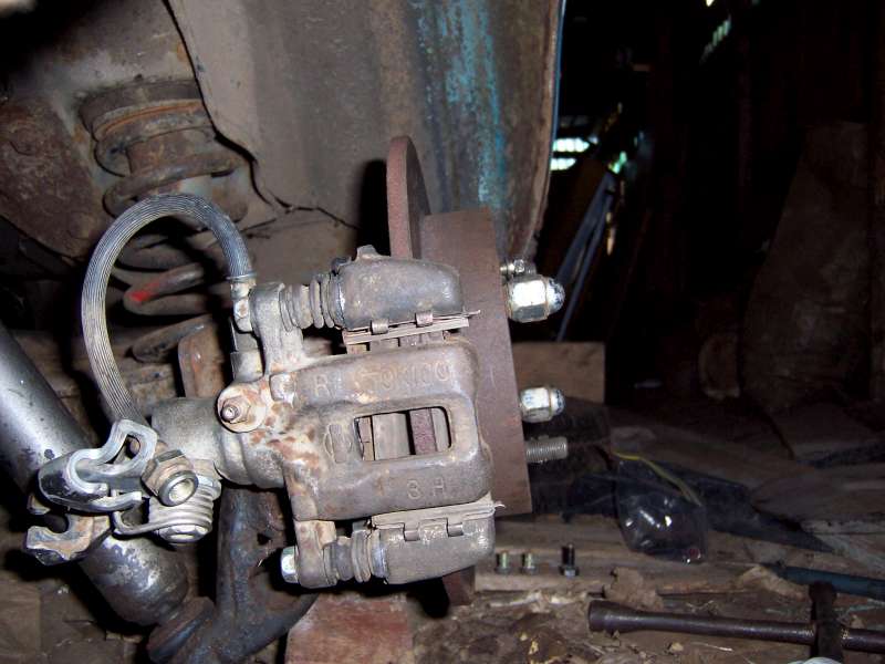

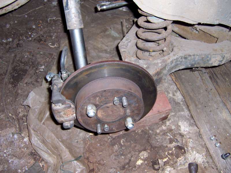

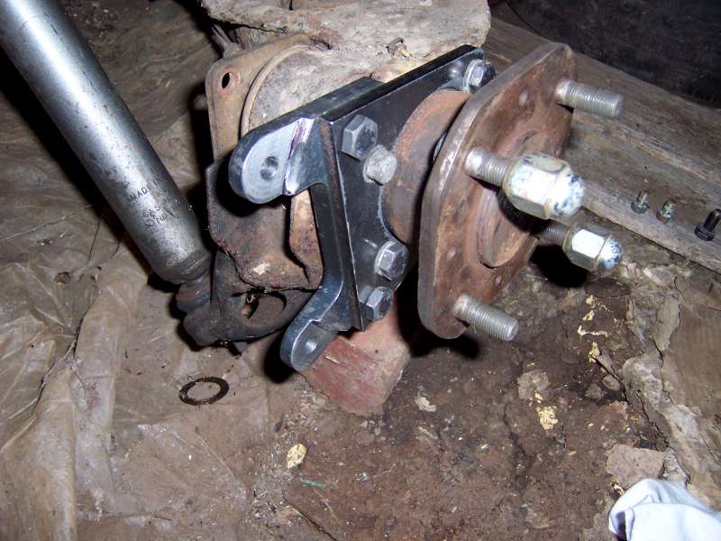

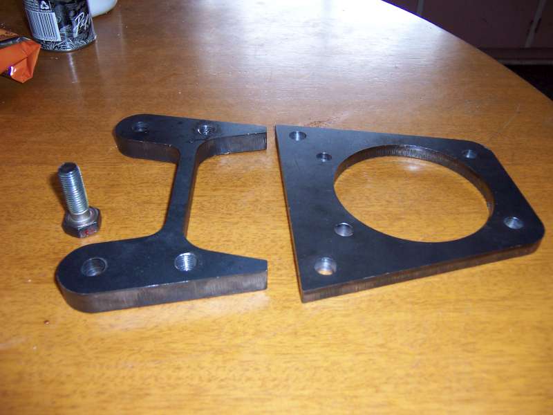

Posted April 26, 200817 yr comment_245395 Hi all, I've been slowly getting the bits I need for my rear disc conversion, I had my brackets made (laser cut), and I threaded them, also I had my brother spin down the "tab" to make a 4mm offset to centre the caliper to the disc, as you can see they fit pretty good (on my spare 240k). also here's a link to my web site with more pictures http://noddle.110mb.com/Rear%20Disc%20Conversion/index.html Nigel Link to comment https://www.classiczcars.com/forums/topic/27875-my-rear-disc-conversion/ Share on other sites More sharing options...

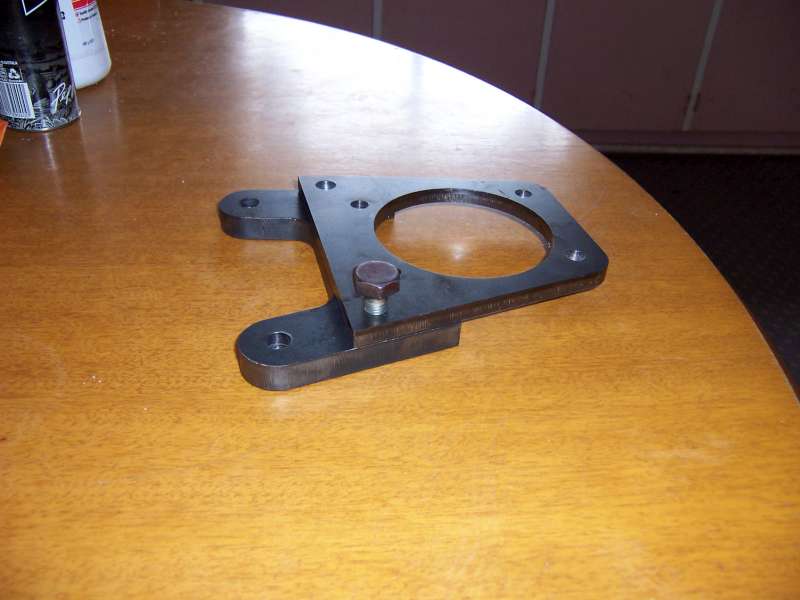

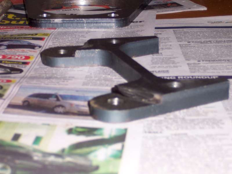

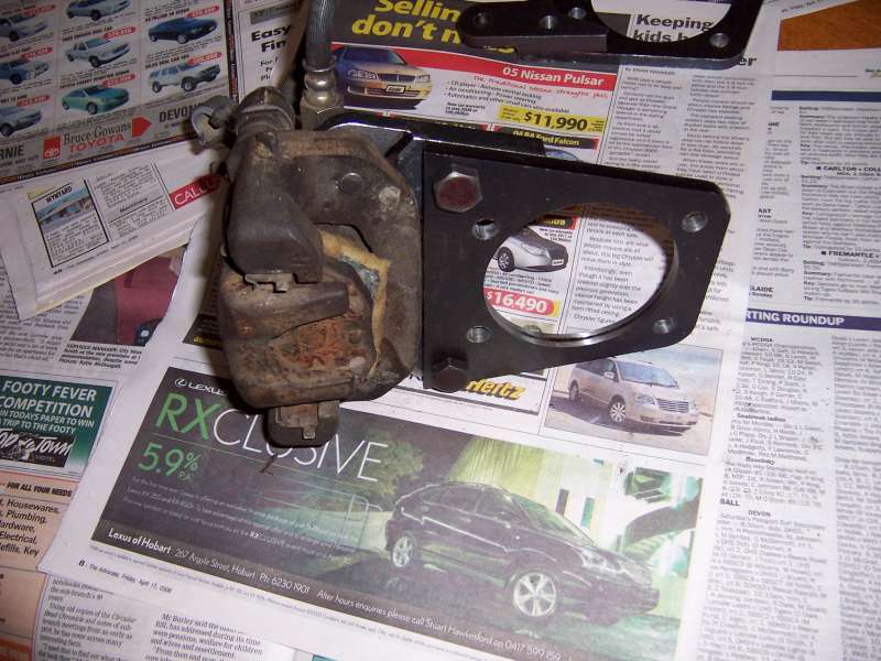

April 27, 200817 yr Author comment_245492 Hi,I used "240K&Beyond" original CAD drawing, from this thread http://www.classiczcars.com/forums/showthread.php?t=15930&highlight=bracket+240Kit was a one piece bracket, there is no one around where I live, that could do a C&C bracket for me, (cheap enough anyway)all I did was "hack" it so it was in two pieces, it cost me $37 to get the two sides made (4 pieces)and all I have to do is bolt the two half's together, the engineering place offered to weld them, but I preferred to bolt them as I saw it would be easier to get them passed by a engineer .I'm sure if anyone wants the original CAD drawing, 240K&Beyond, would be happy to give you a copyNigel Link to comment https://www.classiczcars.com/forums/topic/27875-my-rear-disc-conversion/#findComment-245492 Share on other sites More sharing options...
April 29, 200817 yr Author comment_245587 This is the CAD drawing for my bracket, it was based on 240K&Beyond original CAD drawing.Disc Bracket 240K-Bolt.dwg Link to comment https://www.classiczcars.com/forums/topic/27875-my-rear-disc-conversion/#findComment-245587 Share on other sites More sharing options...
