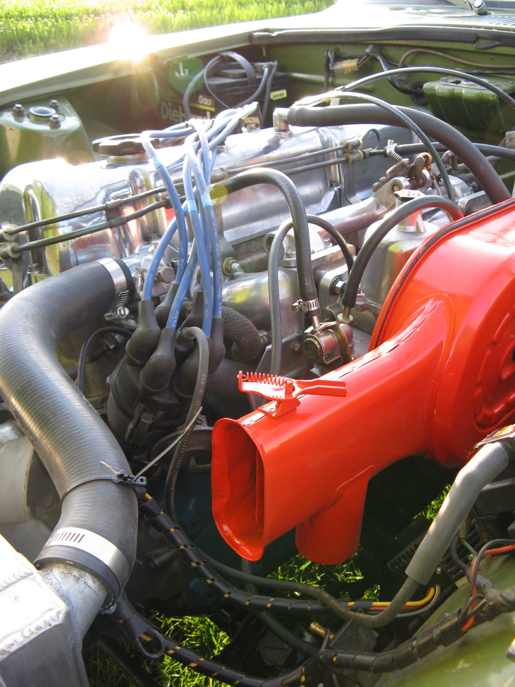

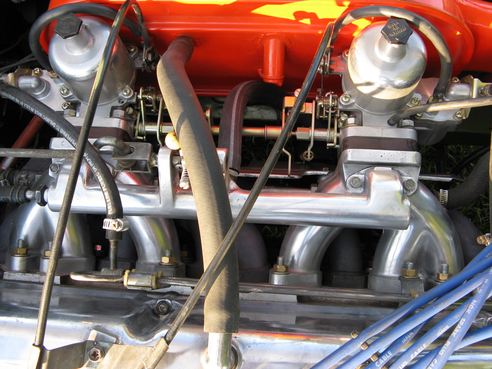

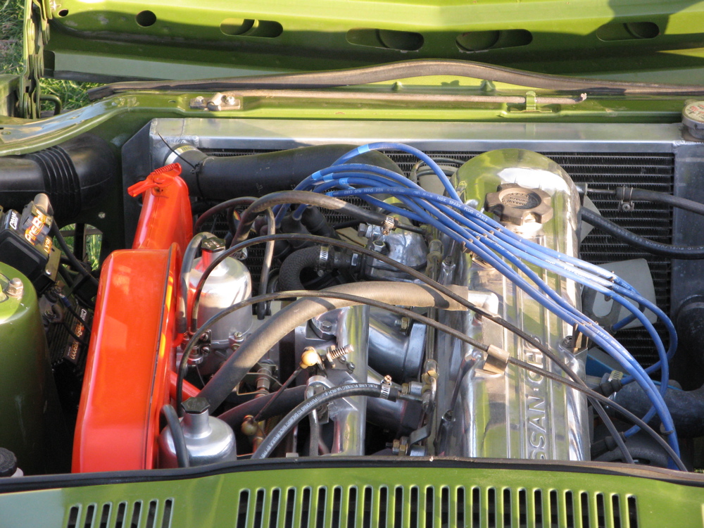

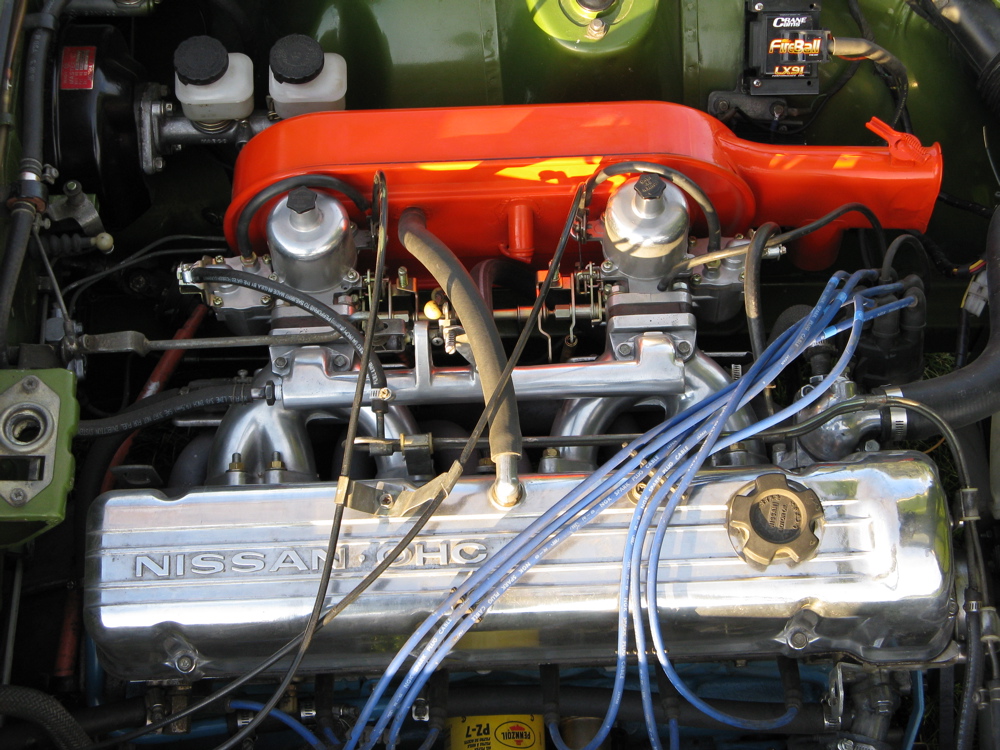

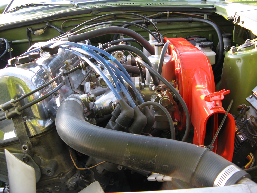

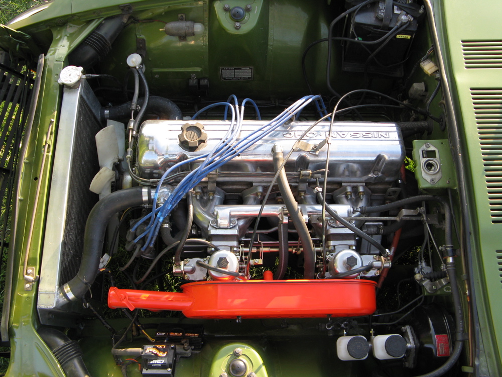

Posted April 19, 200817 yr comment_244586 Today at noon I finished putting a 83 l28, with Ztherapy su's and a n33 intake. I also cut all the junk off the balance tube and welded all the holes, then ground welds down and polished the tube and intakes. I was in heaven when my 73 240z fire right up on the 1st try. I spent the rest of the afternoon going nowhere fast, and fine tuning everything. Wow what a smooth power-plant. Alot of what I did was researched on this site. Thanks so much for the time many of you have spent over the years sharing your ideas and information. Digging for the ghost of past Z's and reading about what makes a great car better has made this a journey to treasure. Jon Link to comment https://www.classiczcars.com/forums/topic/27774-just-finished-transplant-swap/ Share on other sites More sharing options...

April 19, 200817 yr Author comment_244619 Here are some photos of the finished swap. Link to comment https://www.classiczcars.com/forums/topic/27774-just-finished-transplant-swap/#findComment-244619 Share on other sites More sharing options...
