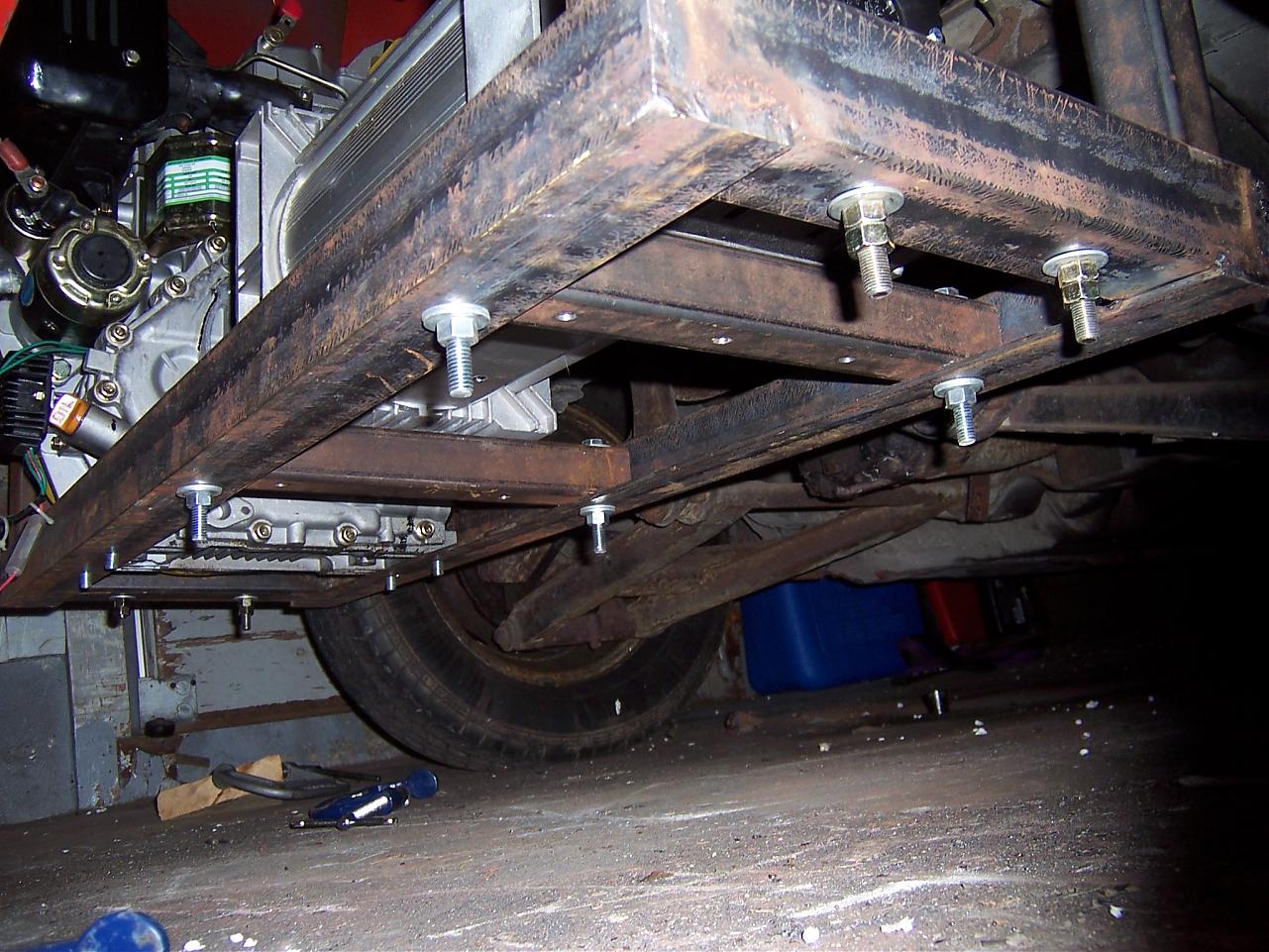

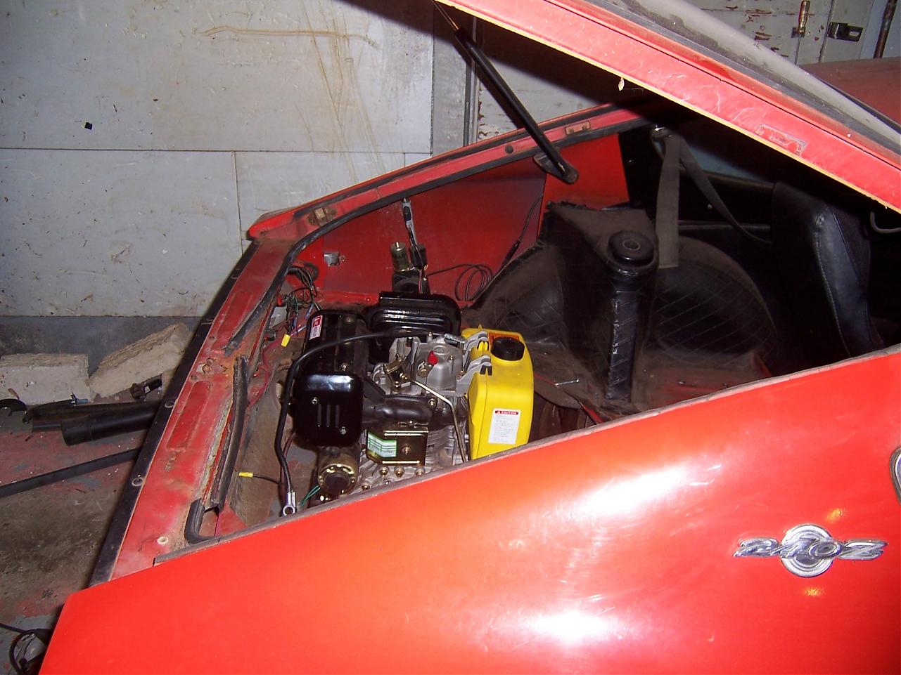

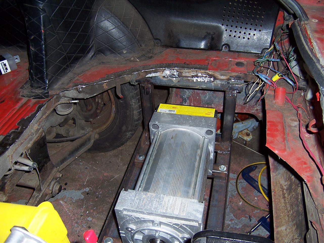

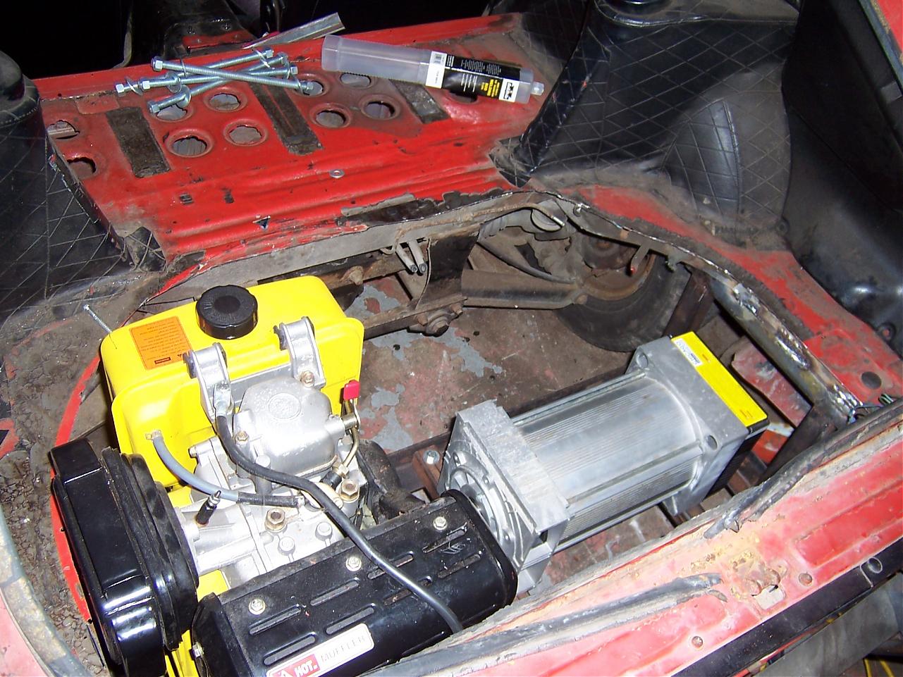

Generator is f-i-n-a-l-l-y in the car. This part of the project seemed to drag on forever. I hope to get the wires run and some preliminary mileage numbers within just a few days. Next step is to get the exhaust fabbed up.
