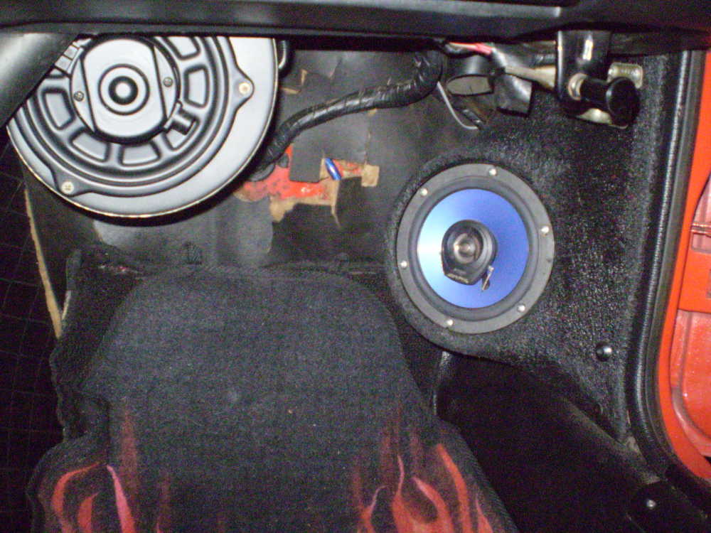

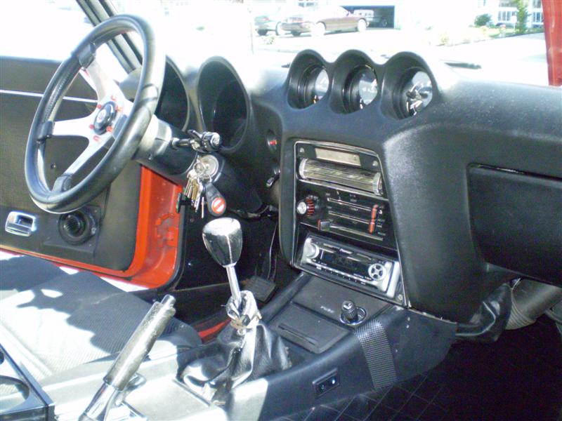

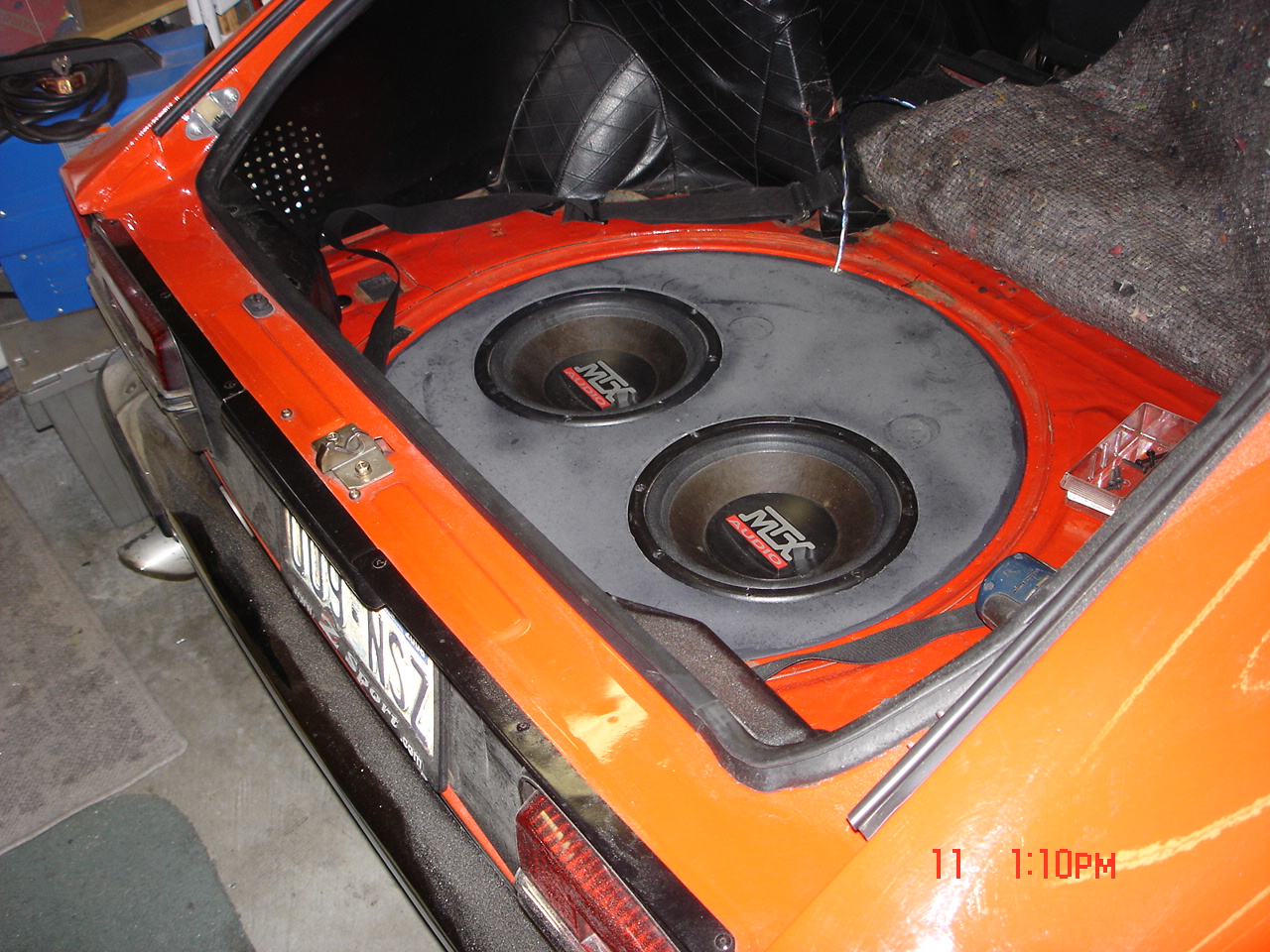

There is just enough room for a standard DIN radio (2" x 7") deck. Just takes a little trimming here and there. BUT BE CAREFUL when you cut out the 2x7 hole, the plastic can brak on the bottom half of that hole. If you break it, you'll just need to make a trim plate out of 3/32" ABS plastic. (I have some here)
I have a Pioneer AM/FM/CD/XM radio in the dash, 2) 400 watt Coustic amps, 2) 4" kickers in the doors, 2) 5-1/4" Pioneer 2-ways in the rear, 2) Alpine 6.5" 2-ways in custom kick pods in the front kick panels, 2) 10" MTX Subs in a custom spare tire well enclosure. I use 4 ga power wire, gold plated solid brass distrobution blocks and battery terminals. Metra 44PW-22 power antenna, and Monster cable interconnects. (RCA cables)
I also Have Power windows, power locks, full alarm w/ keyless entry and a seperate DVD system w/ 7" monitor under the dash. Go to my gallery for pics of everything else.
