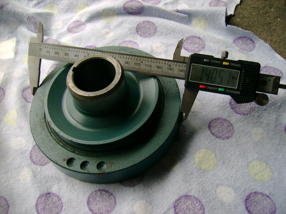

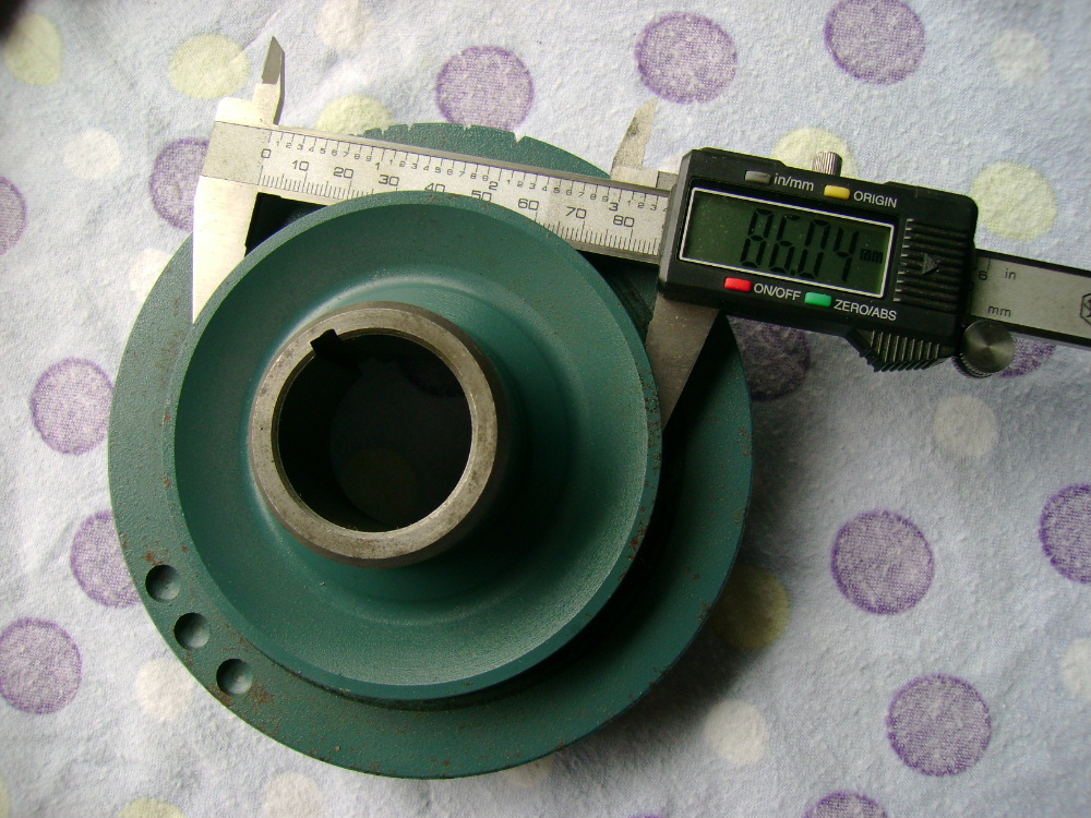

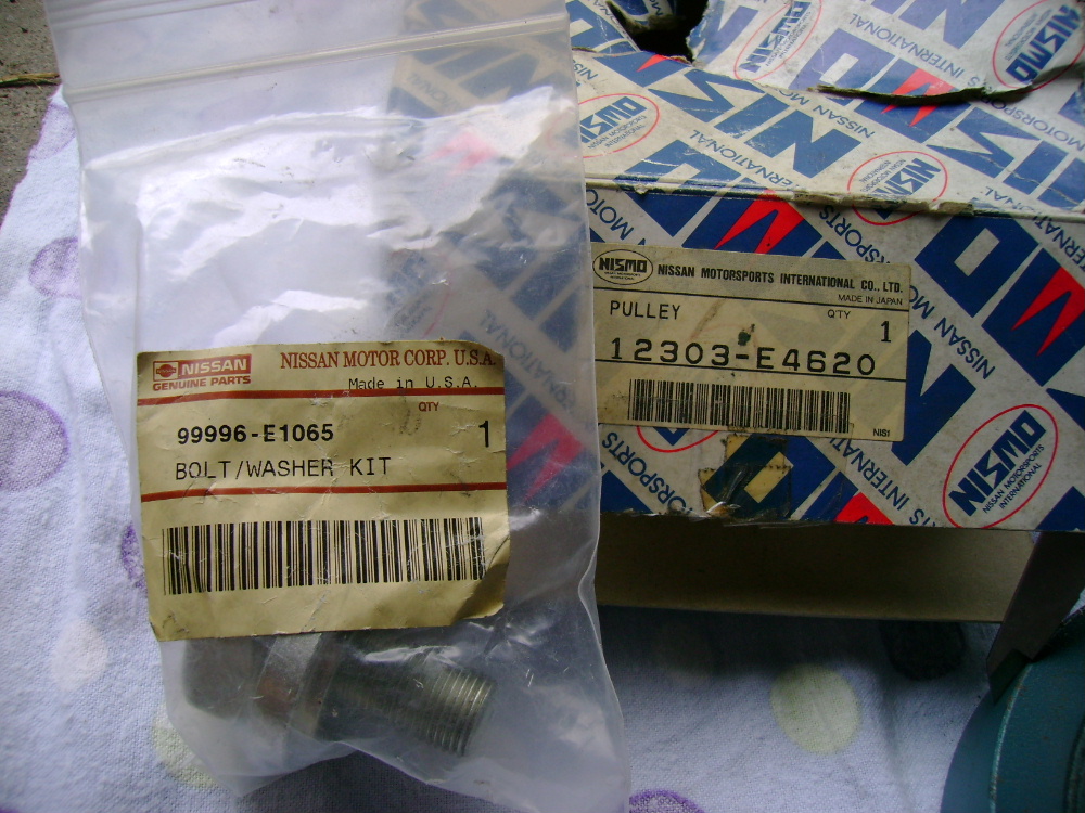

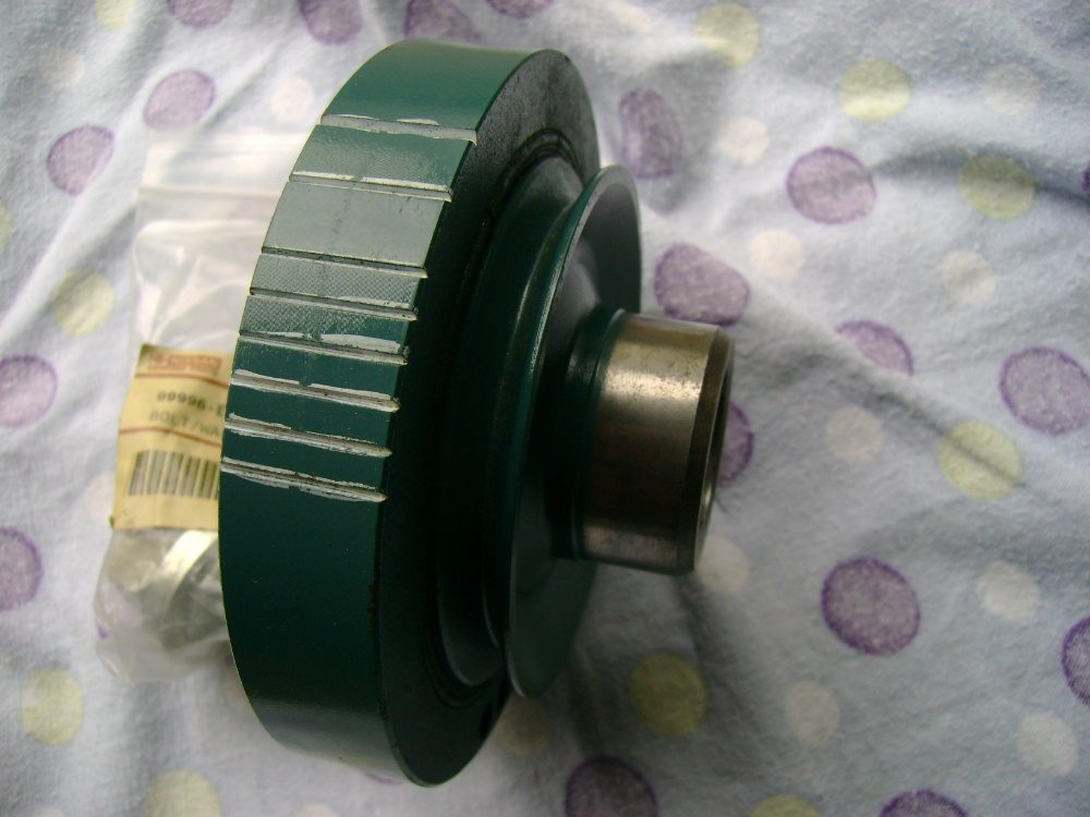

I threw in a couple of pictures of what the Nismo balancer looks like. Needs a special bolt and washer setup...the bolt is longer and the washer registers with the face of the balancer. Note the small width of the pulley groove.

I purchased one from MSA and found that the belt groove was to narrow and that the keyway slot to small. I took it to an engineering shop with the original one as a model and they machined it to take the standard belt and the right sized key to locate it on the crankshaft. Also the timing marks needed to be painted on in the correct spot. Otherwise it seems to work ok!
I did notice that the fit onto my LD28 crank was a little too tight. I didn't measure the internal/external dimensions of the two, but it seems that there is work to be done to make it work. So too the pulley groove. Why did you have to repaint the timing marks...what was wrong with them? Was there a manufacturing issue with the marks...and crank bore? Seems odd that Nissan would produce something that needs so much 'corrective' work.
