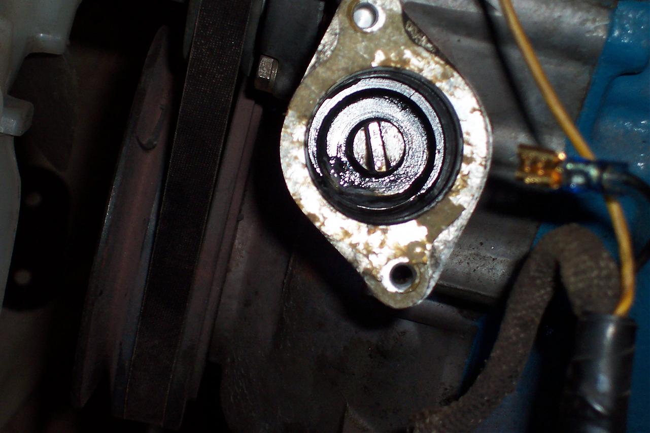

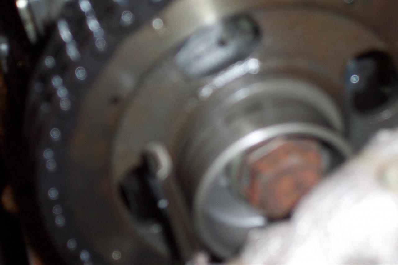

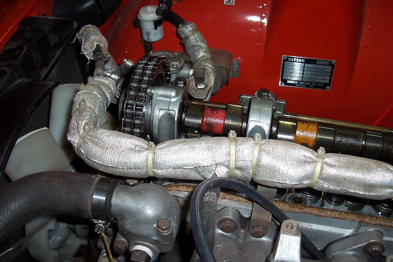

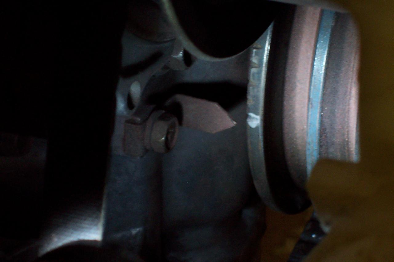

May 3, 200817 yr comment_246073 Thanks xray. Sorry if I was a little pissy yesterday, I think it was a long afternoon of frustration that got to me. And yes, I did replace the oil pump with a higher volume pump, so the dizzy was out. Heres exactly where I'm at timing wise as of last night, when I finally quit and hit the Stolichnaya & tonic. First is crank indicator, dizzy tab location, cam lobes fully opened, and indicator notch on the timing chain gear (if its tough to see, it very close to 12 o'clock on the cam tower), which I believe is right. I can't really see the engraved line thats supposed to be on the cam tower though. The timing chain has never been removed, I wood blocked it when the head came off, and it never moved. I didn't even let anyone touch the motor when it was apart. I run a local mens softball league, and we have a tourney this weekend. Have to go get things started but I'll be back home this afternoon, and I'll get back at it. Thanks. Link to comment https://www.classiczcars.com/forums/topic/26868-trying-to-get-her-started/?&page=5#findComment-246073 Share on other sites More sharing options...
May 3, 200817 yr comment_246082 Judging from the first picture, the pointer seems to be just silghtly below the notch on the pulley. You need to move it to where it is perfectly lined up and then check the position of the tang which looks to be too far left in your second pic. Link to comment https://www.classiczcars.com/forums/topic/26868-trying-to-get-her-started/?&page=5#findComment-246082 Share on other sites More sharing options...

May 3, 200817 yr comment_246134 I keep that 8mm bolt centered. I suppose you could move it but it won't make up being off by as much as yours is. The oil pump has to come out. If you do what you suggested in the other thread you started I think that would take your timimg to somewhere prior to the timimg mark about as much as you're beyond it now. I won't really run right until you get that distributor drive in the right spot. Link to comment https://www.classiczcars.com/forums/topic/26868-trying-to-get-her-started/?&page=5#findComment-246134 Share on other sites More sharing options...
