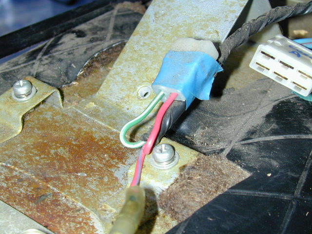

Thanks for the tips so far, I think I am narrowing things down. I tested the electric fuel pump today and found that it has no current running to it... I'm thinking that's a problem. As I indicated earlier, the dash and console condition lead me to believe that the wiring has been an issue prior to me buying it. I traced what I belive to be the fuel pump wires from the passenger side kick plate but did not find an inline fuse (as I have read, there should be an inline fuse somewhere between the kick plate and the fuse box) - it just connects into a bundle of wires behind the radio. Here's another puzzle, once I completely removed to console I found an extra connector (unconnected). It has one green and two black wires... but where does it go/what is it for? and could it be related to the fuel pump? I have included a picture of the unidentified connector. I anyone has suggestions I would greatly appreciate them. Thanks and happy new year.

My right hand drive 73 240 does not have this plug. In looking at the wiring diagram for the US model it could be related to the auto transmission, either the kickdown switch and solenoid or some sort of thermo switch.
From what I can see the other side of the inline fuse for the fuel pump gets it power via the ignition switch (Black white wire) and is common with the power side (black white wire) of the 20amp "common fuse" in the fuse box. I would check if you have power at this point in the fuse box with the ignition switched on and if so you need to find that inline fuse as it is most likely blown.

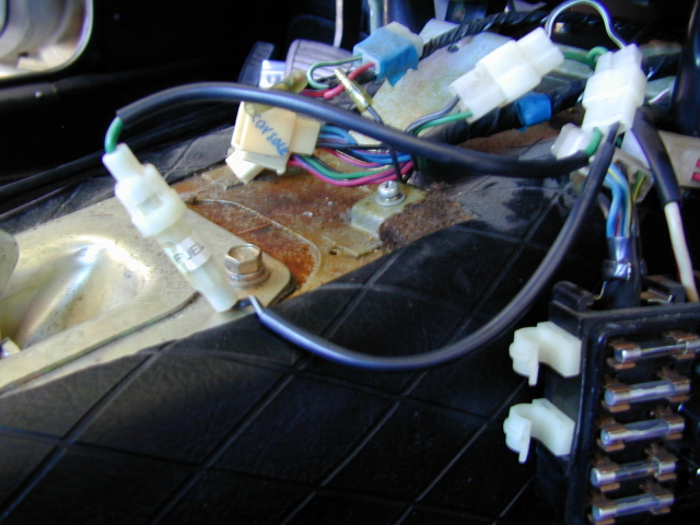

Not sure what the connector you have connects to or for.
In your photo, you can see the Fuel Pump Fuse connector just upwire from the one you are holding. The Fuel Pump Fuse basically bridges the two wires coming to it. See the attached photo. Not sure what the "other" half of the connector connects or connects to. There are several circuits in the harness that in vehicles produced during model transitions that did or did not have full functionality. The Fuel Pump circuit is present from the late Series I through ...
But if you'll note, the fuse holder just connects the Black/White to the Green wire with an in line Fuse. It would be easy to say that the other connector is for the Fog Lamps, but that has a different wire color combination. (Green/White and Red, see second picture)
