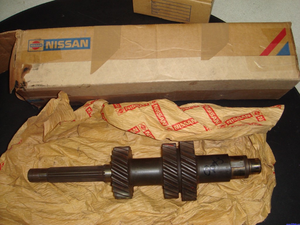

Hi all,
Bought this weekend an ‘option 3 competition gear’. Nissan part number is 32212-E9601.
This number belongs to the counter gear and I was wondering if this part is one-to-one interchangeable or do you need also the gear 1,2 and 3.
Obvious it is made for the FS5C71B box as all the gears are solid on the axe, and with the FS5C71A the biggest gearwheel is separate.
https://www.classiczcars.com/forums/topic/26245-option-3-competition-gear/
Guus,
You need the corresponding Option gears for that 32212-E9601 cluster:
*1st Main: 32343-E9601 ( 28t )
*2nd Main: 32242-E9601 ( 25t )
*3rd Main: 32252-E9601 ( 24t )
Good luck finding them.............. :ermm:
Guus,
Thanks for the quick replay, although the outcome isn't very hopeful. But that's the sport behind it; Getting it home............:nervous:
