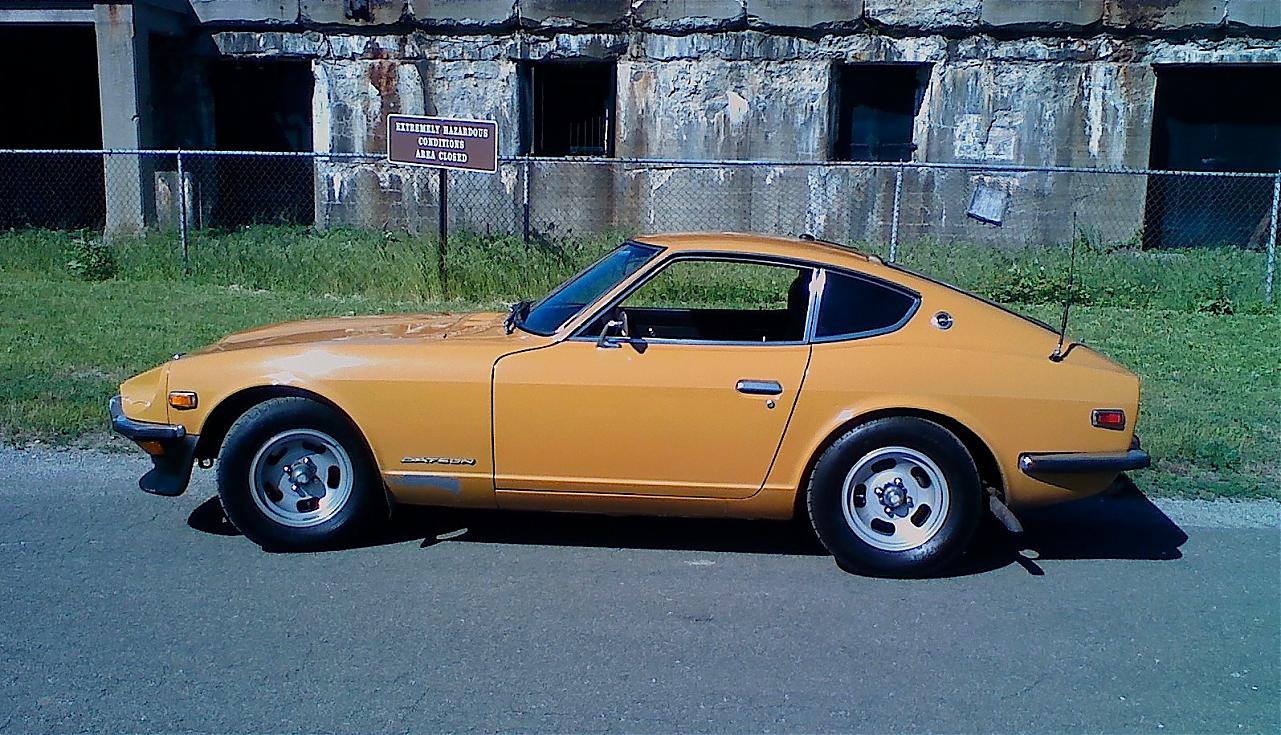

There are many ways to get nice sound. The original owner of my 240Z replaced everything behind the Y of the stock downpipe. Way low-tech and simple. Consists of 1-7/8" crimp-bent pipe, and a 24" generic glass-pack muffler where the resonator used to live. That's it - small pipe size, no rear muffler, just the single glass-pack. The sound is actually quite nice, not overly loud, no resonance, a mellow note reminiscent of early Jags or a 95-99 M3. So nice sound isn't hard to get.
