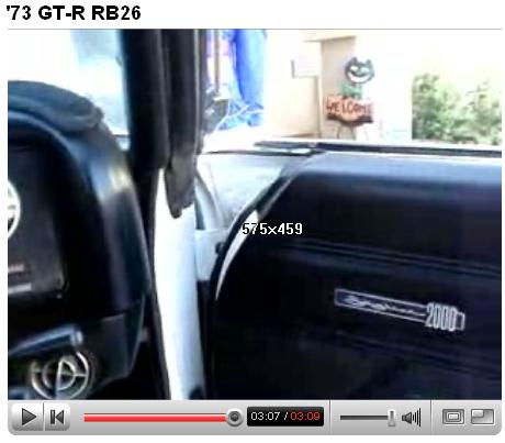

It is very nice indeed, just a question , is this a JDM car ?, the reason I ask it during the video clip I spotted this.
the welcome halloween cat?

Hi Noddle, Brian,
As Brian says elsewhere, this car started its life as a genuine JDM version C110 Skyline 2000 GT-X. That badge is something the previous owner Ray Ferguson had souvineered from one of his mid '60's Prince Skyline GT's (S54-B)They were originally placed on the glovebox lid in the Prince. Sharp eyes there Noddle!:)
