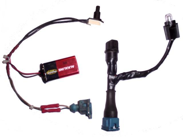

These are my home made injector test tools. They're simple, they work and I've never had any problems with them. The one on the left is self-explanatory and the one on the right if you remove your injector connector, place it on the injector and place the connector on top, it will show if you have a signal to the injector while cranking or running the engine.
crafty tools my friend you should bring em over , i mean hell you live like 45 minutes away :) i am from apple valley :) well i got the fuel rail off but it got dark so i couldnt continue working. ill be back at it again tomorrow and ill update everyone then. thanks everyone.
