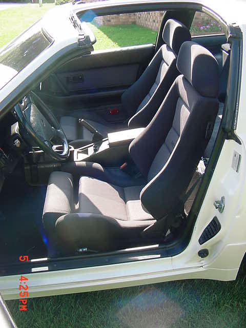

This is the shape/diamnetions of a recaro seat that my friend is selling.
when i measured my stock seat it seems very close to me. my stock seat bottom is about 21.5" wide (probably flattened out from 31yr use) and about 32" tall, width of the seat seams to be a tad wider but there seems to be room.
Can anyone who has done a swap look at these measurements and know if it'll fit (obviously with some fab work for rails)
Real pic of seats here:
Thanks!

Well with a little fab work and a whole lot of luck I was able to get both recaro's into the Z this weekend. the drivers side was a PITA due to a drivetunnel bulge that wasn't on the passanger side, but all in all I can drive the car and the seat adjusts enough that amanda can get comfortable in the driverside no problems. The passanger side was a piece of cake, first try bolt right in with my 'adapters' which was a good start before i found out about the tunnel issues..LOL
needless to say here are the pics, and yes they will be recovered to match the car. we are thinking black leather to replace the grey and red micro-suede inserts :D
There are no issues with them touching the door panels, nor the handbrake on the passanger side and the head rests are JUST inside of the roll bar when reclined far enough.
i had recaro seats in my 88 SS and loved them. the seats can be used either side, and i lucked out and found a mint passenger seat out of a wrecked SS, and traded my worn out driver's side for it, along with a little cash. the slide out thigh support was a cool feature on those also.
