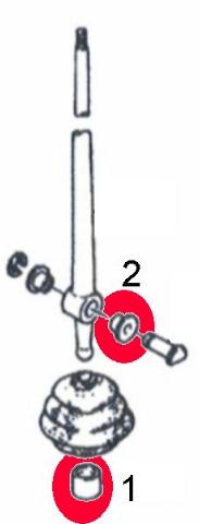

You most likely need to replace these. 32855-H1010 which is a bushing that goes on either side of the shifter, you'll need two, and 32861-N4200 which goes on the bottom, you'll need one.

Thats exactly what it feels like too, the #2 bushing out of sinc.

Thanks again for the diagrham :)

No, it should be pretty solid. Sounds like the two side bushings are worn pretty badly or gone. MSA should have them but their numbers will be different as those are OEM Nissan part numbers I listed.

I was going with the simplest solution first. Those bushings are usually worn or even missing on many cars I've looked at plus he says he feels play and can move the shifter up and down. That and the fact that he's had the car long enough that a leaky slave or master would probably be past the point of driveability by now.
Good point Stephen, if your shifter has that much play in it those bushings should be replaced regardless.
I replaced my original plastic ones with brass and was very happy with the improved shifter feel.
