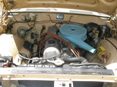

I've found this pic in a local website, for the people that have not seen how it looks an engine bay of a 240C....may be this will help!!!
The engine bay of dat180's car probably doesn't look quite like that one since the one you pictured is LHD.
Ohh you're right i didn't realize he is in New Zealand, my mistake, and my little knowledge of english....
greets from Colombia
