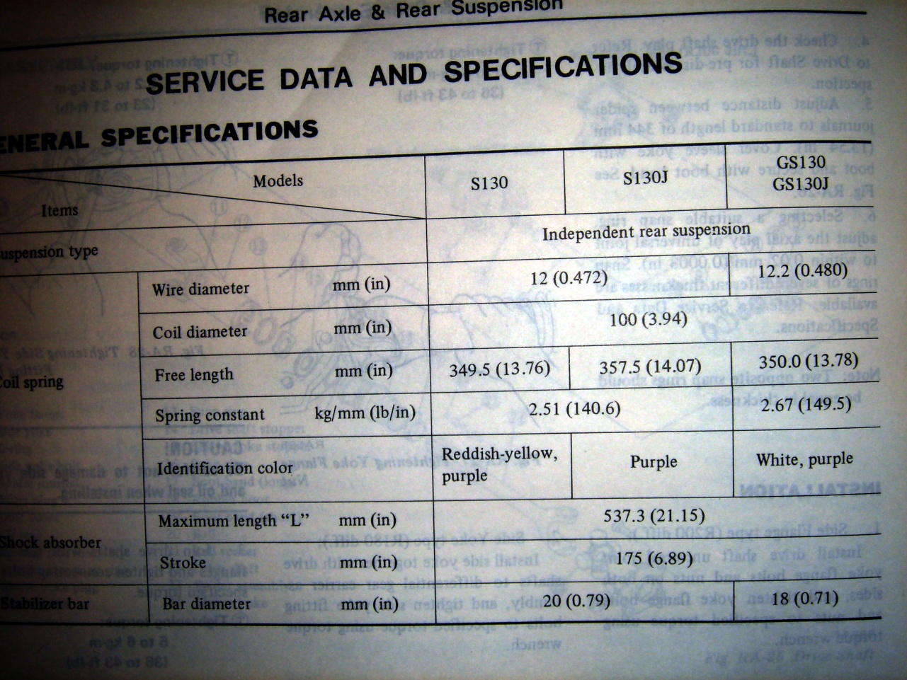

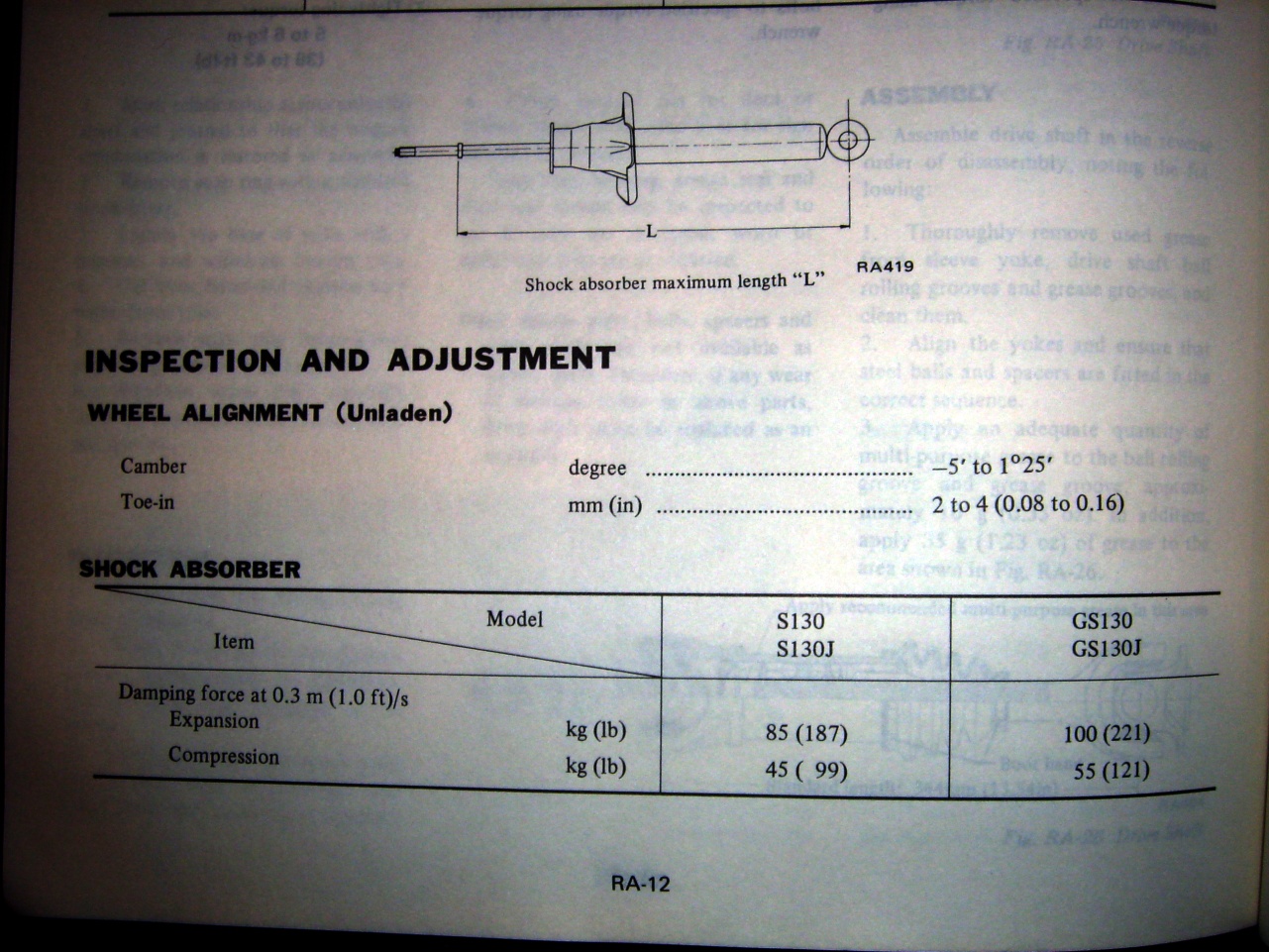

Here are a couple shots of my FSM regarding the shocks. The dimensions are the same for the two versions, but the compression/expansion measures are different. If you want other pages, let me know, but this one page (split in two for easier viewing) pretty much covers it.
