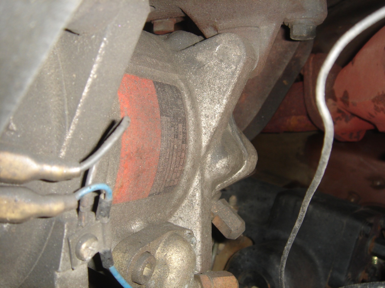

Any how, I'm thinking about before summer to get it put on (maybe have the compressor rebuilt which it may need), and re-charged. I took a couple pictures of it and was curious if you could identify if this was a factory a/c compressor or if it was a dealer a/c style compressor? There's probably not any difference between the two, but I don't know enought about these and would like to learn a little more about it. Also, what color were they orginally? Before it was put on the car I'd like to clean it up a little bit and paint it if I could. Thanks guys.
That looks to be a Hitachi MJ167 which is a factory installed compressor. They're pretty much the color of yours, minus the rust. If it worked when it was on the 260, I'd try it out first before going to the expense of having it rebuilt. I've installed a few straight from the junkyard (after leak testing them) and they still worked.
Thanks for the info, is this kind of a rare part, or was a pretty commonly used compressor? Thanks again.
It was pretty common. I have the same one on my 810. I occaisonally see them on eBay and I think Norman at OEM Surplus has a few of them.

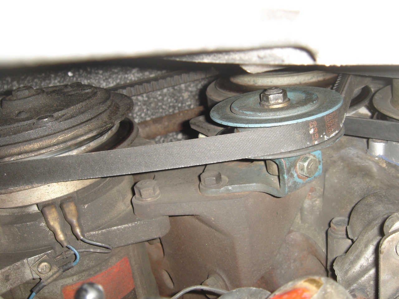

Would it be possible at all for someone to post a picture of the compressor on their 260z or 280z mounted to the mounting bracket on the side of the engine? The compressor seems to have a few mounting points and it would be helpful to see how one is already hooked up to give me an idea on how it mounts on to the car as I've never had it on. Thanks!
I think I've got it figured out on how it goes on and everything. From my understanding, it does not use a one of these (picture below) belt tensioner bracket for the a/c belt, it uses the small pulley on the bracket for the belt tension? Other than that, I think I'll be able to get it on in no time and have it recharged!
The factory air does not use the brackets you pictured. The compressor bolts solidly to the bracket on the side of the engine and uses an adjustable idler pulley for belt tension.

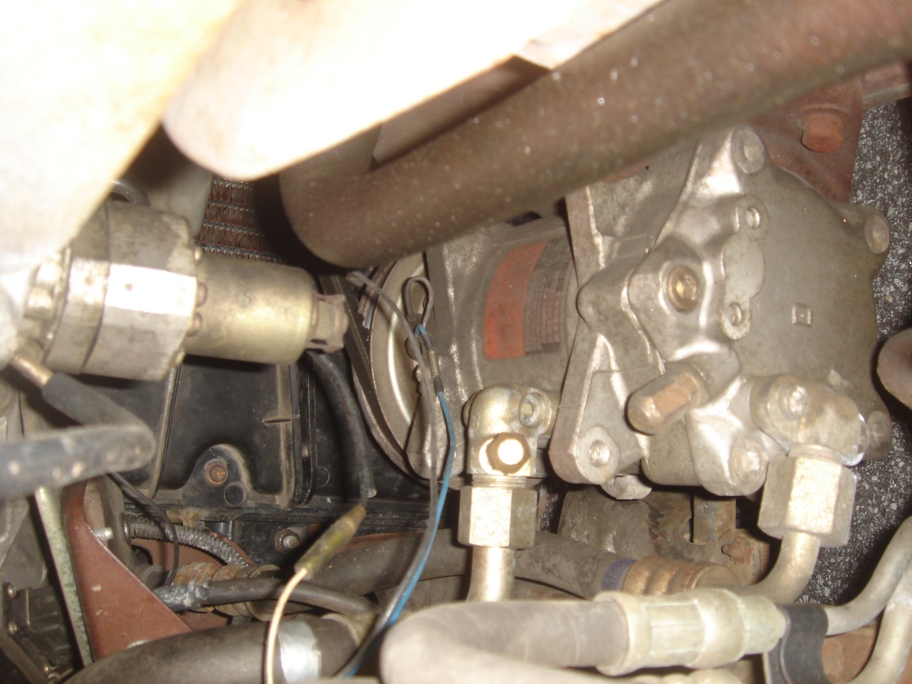

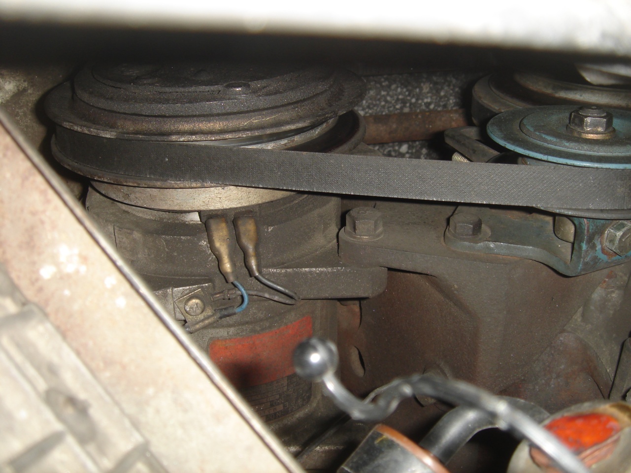

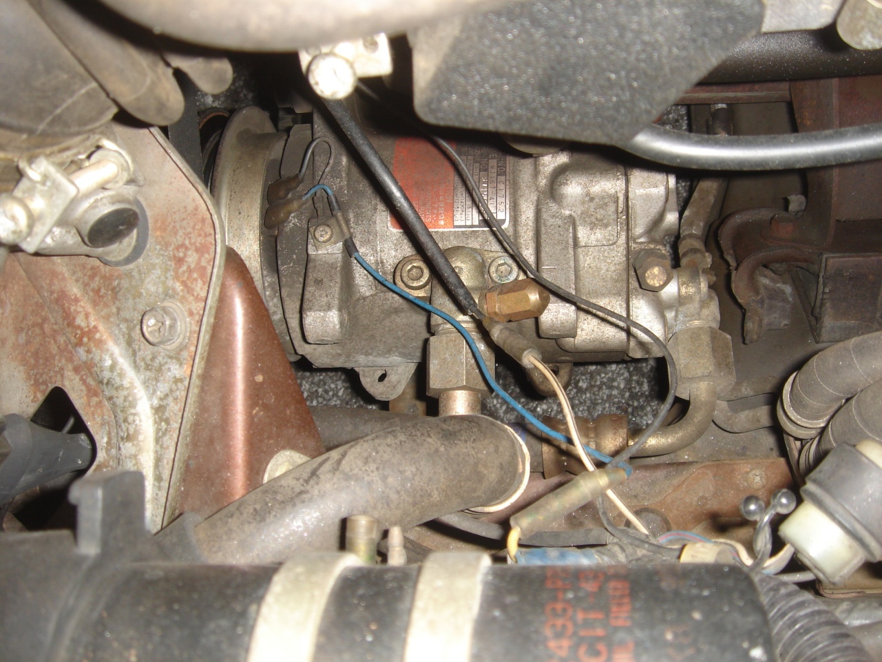

We have the same compressor and engine, so I figure I may as well post these shots to give you an idea. Note that the Blue Pulley is the one mentioned by Stephen
