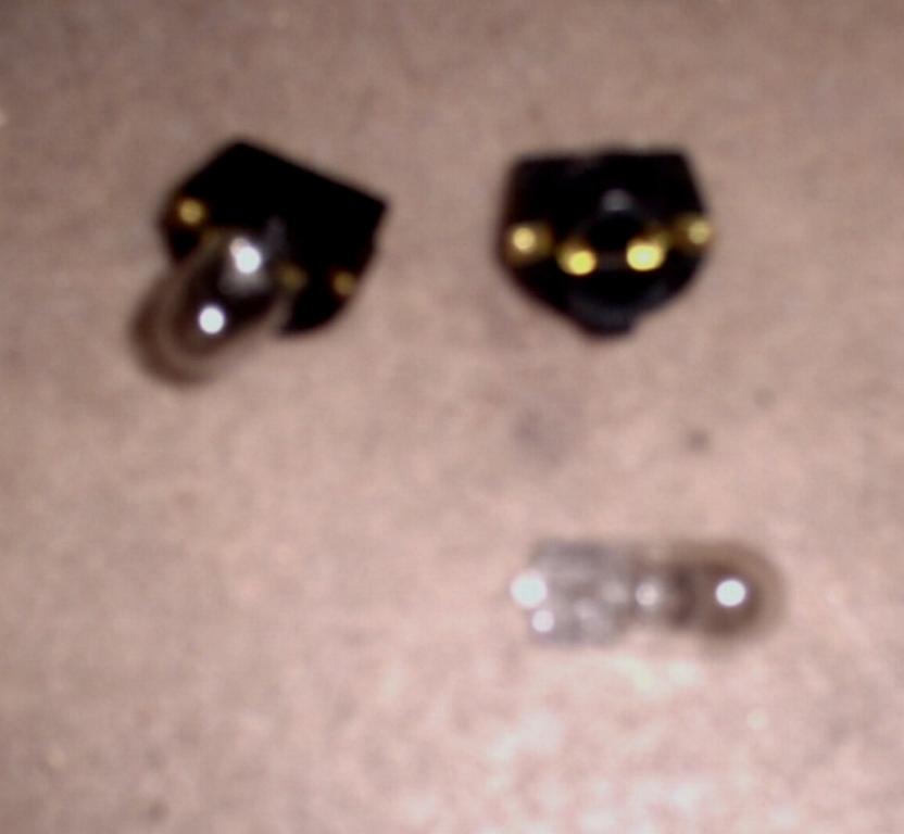

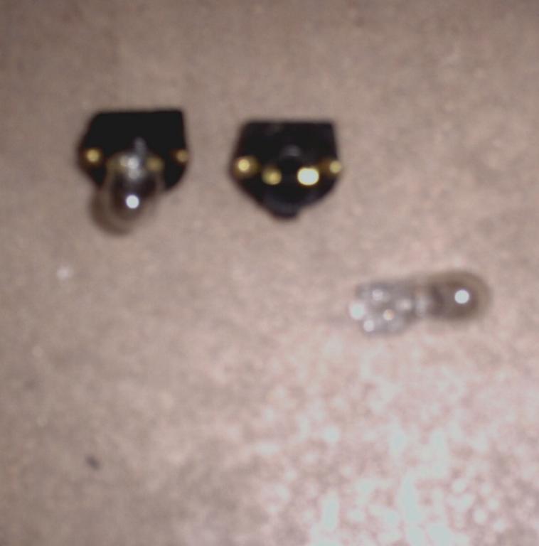

Are these the bulbs? Sorry about the picture quality. If so they are still available from Nissan. Part number 26261-89900 for about $1.50. They are bulb number 158 and we also have them at Ace Hardware.
