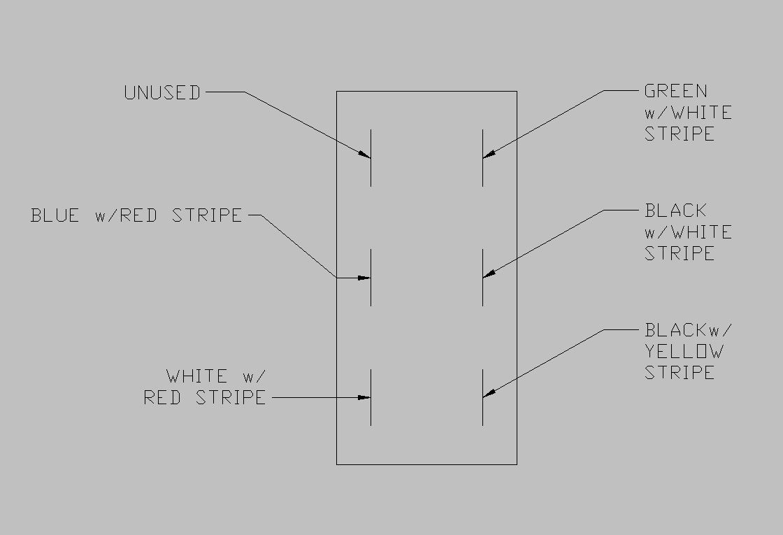

Anyone have any pics of the connector that goes to the back of the actual ignition switch? My '70 did not have any wiring and I am needing to wire up a new connector.

The problem may be in getting the "new" connector.
Other's who have tried to find them have found them to be somewhat elusive.
IIRC Dave Irwin (Z'sondabrain) had them for use when he manufactured the Parking Light Relay Harness. You might give him a PM.
The Connector is a 6 Spade Female connector (wide) and they're arranged 3 side by side, and two rows. I hope that explains it. Look at the back of your ignition switch and you'll see that only 5 of the 6 connectors actually get used.

HERE YOU GO...
This is off of a 2/71
The attachment is best viewed at full size
Hope this helps.

Jim:
Exactly what I was looking for. Hopefully I can scavenge a good connector and swap out the pins.

The two wires go on the keyed side of the connector. That is the side with the steps in it. I would post a picture but, don't have the connector accessable.
Thanks Jim. I've gone out to my Z and can see what you're referring to. Thanks again for the help.
