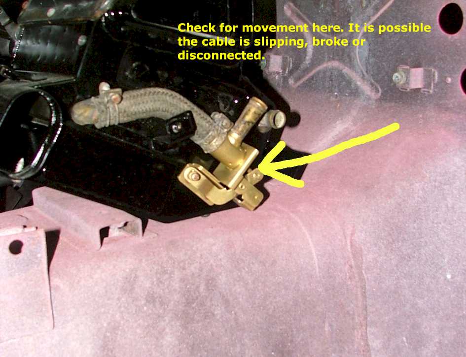

Not physically, apart from the "feel" of the controls (sufficient resistance). OK, so, begging your pardon but how do I determine if the heater valve is bad? And do I need to drop the dash to check it?

If you are sure that the hoses are hooked up to the core and that the valve is functioning when you turn it to hot then you have a real puzzle. The valve is on the passenger side by a vent. (A foot from your knee when sitting) Check that the valve is moving when you shift the control lever. It is possible that someone bypassed the heater lines. Check that the lines exit/re-enter at the rear side of the engine.
To eliminate the valve/heater core as suspects you could always disconnect both hoses and flush with water to check for flow. (Valve on/open of course)

OOOOOOhh Hey! I just remembered. The doors inside your heater box may be different from mine. It is possible that one of the cables to the various flaps is broke, disconnected or slipping. The result is that the heater core may work fine but not be getting any airflow through it. Check the cable on the opposite side of the heater box for function. You should hear the large door/flap opening or closing in the middle of the box. (When shifting from heat to cool)
Try selecting "Floor" and heat or defrost etc and see what happens. Geez why didn't I think of this earlier. Does anyone know the diffs between ventilation plumbing? (240vs260Z)
