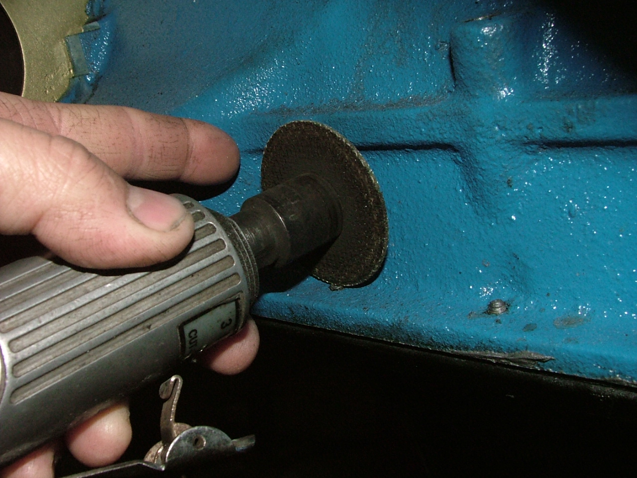

You may be able to notch the head of the bolt and turn it with a small screwdriver. (If it is one of the bolts shown in the pic below) When there is enough to grip with vise grips you'll be set. Take it out through the bottom in case the shank provides interference.
