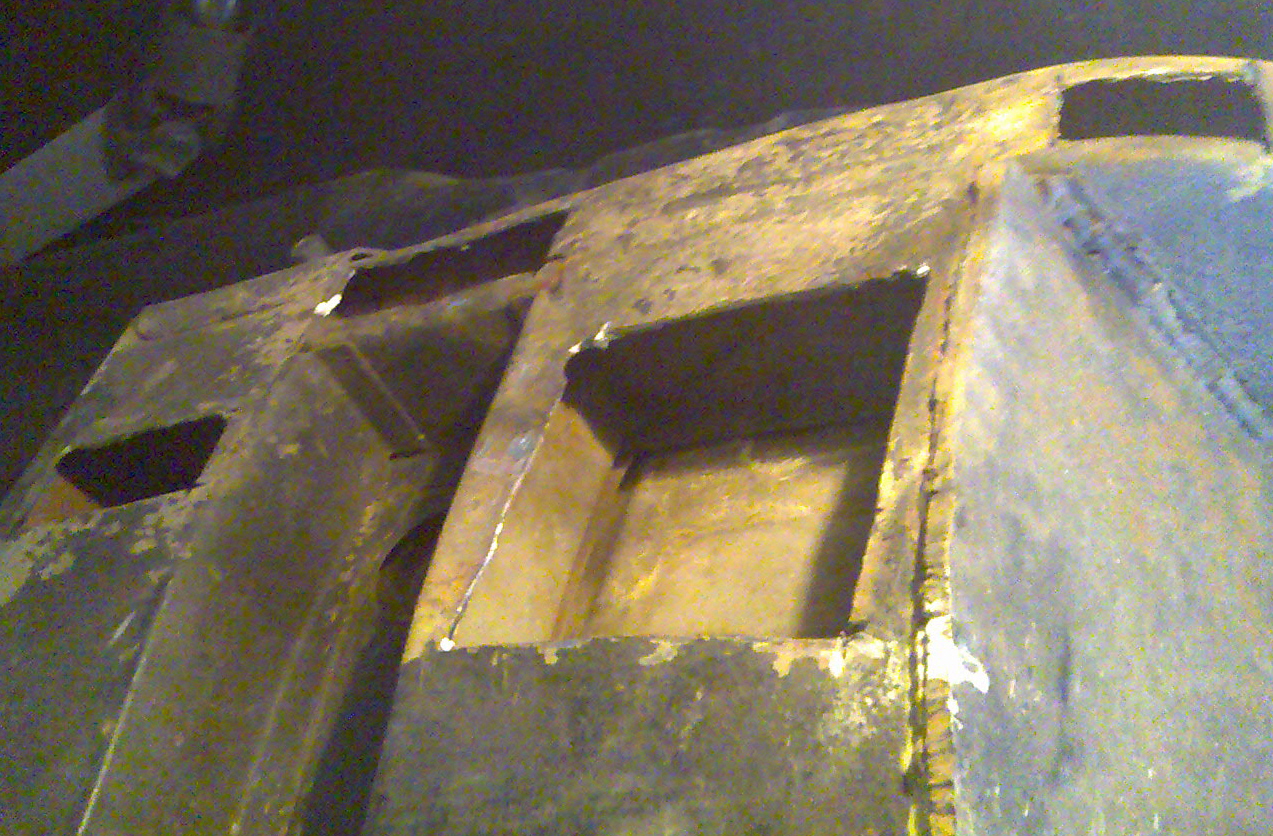

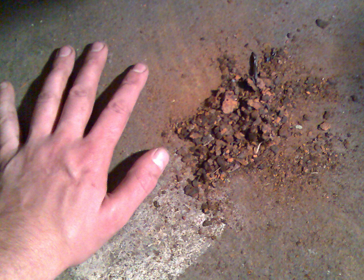

I have attached a few photo's of my passenger side chassis rail, as you can see the long box section that goes into the engine bay was full of rust, the big lunch box size sections next to it were fine. The driver side rail had only just started to go.
This would not be fixed by a sandblaster unless you opened up the rail for them.
Can other K owners go and check the state of their rails please, you can get your finger into the big hole without laying on the ground. I'd like to know if anyone else is having the same problem as me.

the long box section that goes into the engine bay was full of rust, .
also me. early in the 70's & 80's our Ks weren't with enthusiasts, when the car get buncher (air out of the tyre) they rise up
the car (by jack) from any point no care wether that point is designated for raising or no, so sometimes the jack goes inside the body making bends and holes helped by the cumulated rust cos of rain and wet mud etc, also I can blame some workshop whom not care about where to rais the car from.btw I dont take my K to ws unless if I realy cant go further.
.big lunch box size sections next to it were fine...
the two perpendicular rails ? if show photo Anderw

To get into the rails to protect them you can wash them out (por has a product to do this) then blow them dry and spray a heap of fine mist coats into the inside. It was recommended to me to put a few nice drill size holes in them to get the spray in. If you go to one of the places that specialise in rust treatment you will see some body deadener guns with long rubber hoses on them to get into all the little hidden holes.

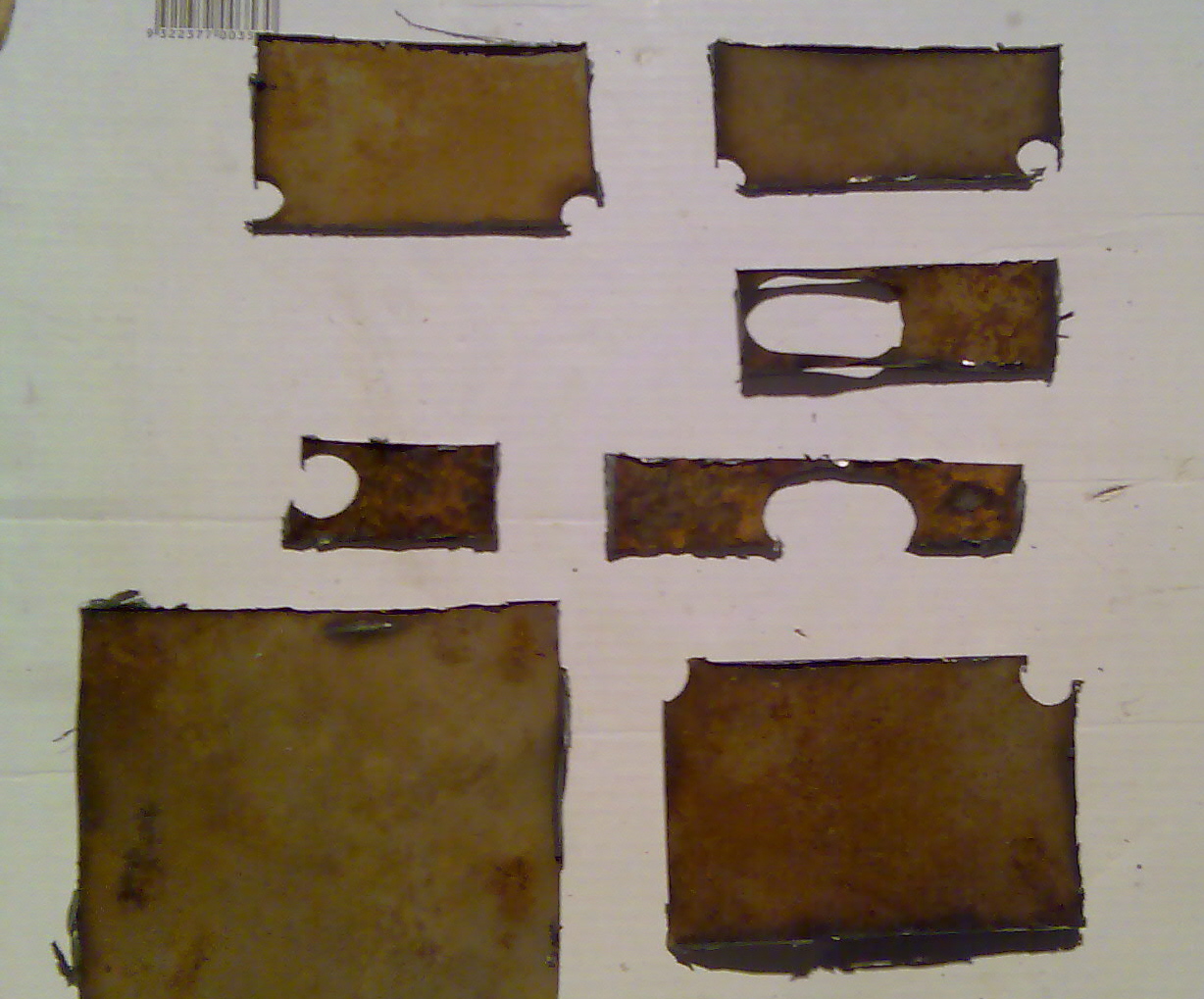

I've just taken squares of steel out so I can get to it all 100%. After these have been welded up I'll have to spray inside again to cover the welds. You wouldn't cut them up unless the rust had attacked a lot of the car and opened up these spots.

I've just taken squares of steel out so I can get to it all 100%. ?.
wont affects the strenght?
this what force to do that. now u need to go in the car cabinet remove the carbet and inspect what is under the driver & the pass. feet
I'll be welding them back up with plates so strength won't be affected.

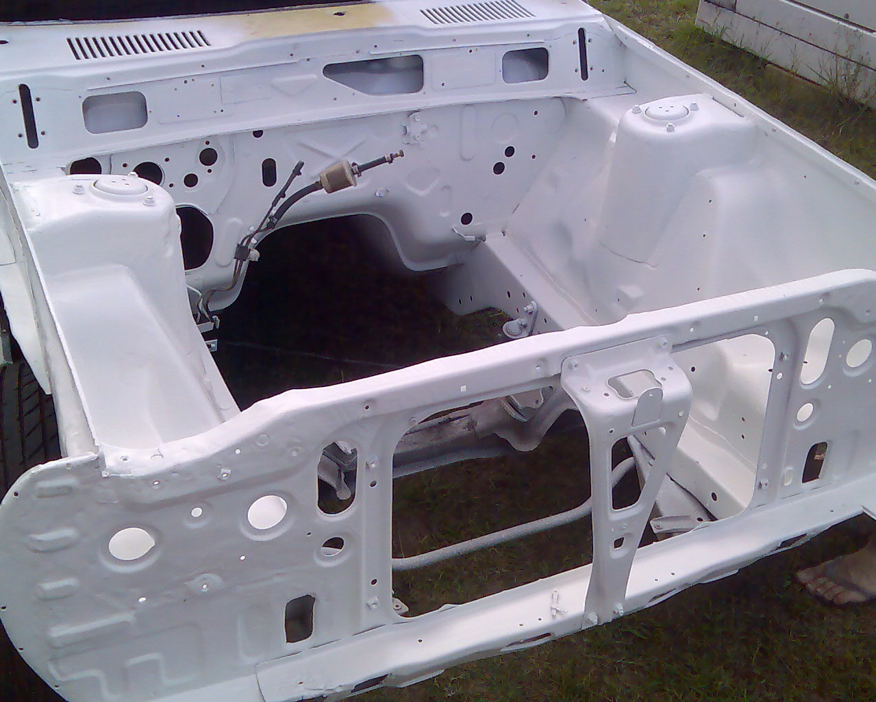

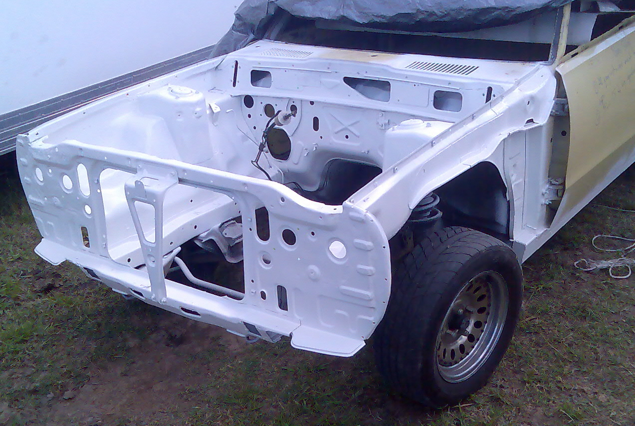

Well I have finall begun the stripping and primering af the shell. I used a pressure pot sander at 160psi from 2 foot away with no distortsion problems but only in the engine bay. We tested what it took to warp a panel and it seems to be when the steel heats up it bends, we had it glowing red on a test piece. I found a heap of accident damage to the driver side front guard, it had been in a small accident but didn't affect the chassis rails.
A lot of what you see i did by my self in about 5 hours with a heap of problems going wrong and only having a mate mix up paint for me. The blaster kept on cloggin as there was moisture in the garnet grit and the gun I was using was just spitting out paint.
I will be using paint stripper to do all the large panels as I can't risk ruining them with the blaster. In the end I'll only use the blaster for the inside cabin and under body all other bits will be done with stripper or the hand help blaster. The small hand held blaster is slow as and is only good for the hard to get to spots.
