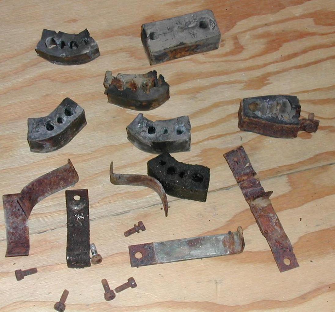

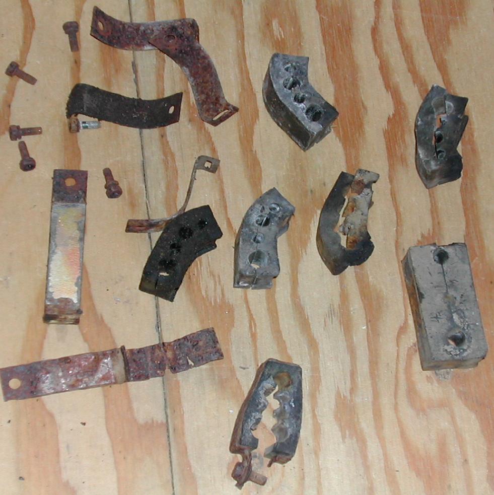

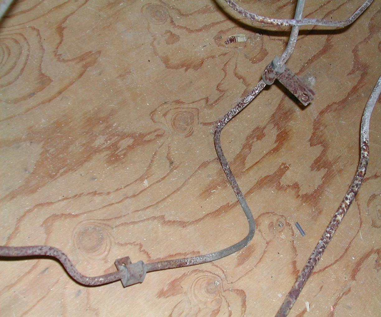

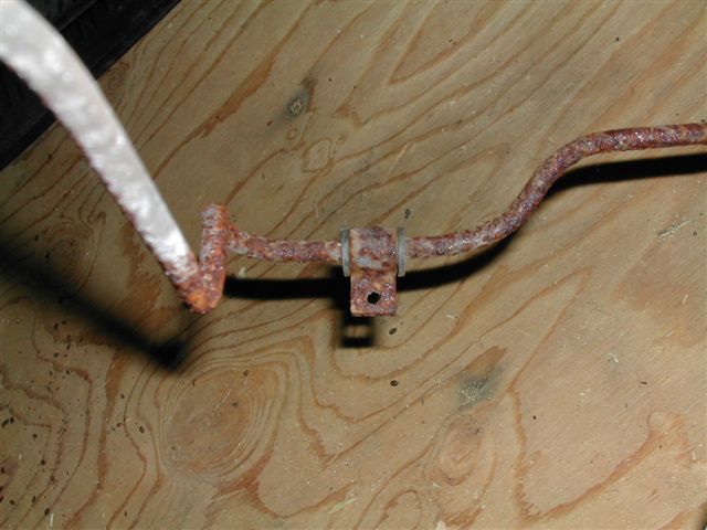

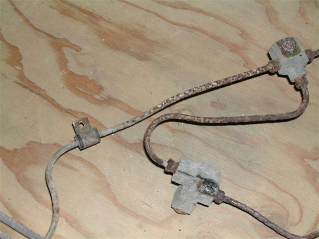

Dont know if these pics will help but it cant hurt to put them up. I went out into the garage and dug out the bag with the hard line insulators in it for pictures. I also took pics of the original hard line clamps still on the old lines. These are off a 72. They arent in the greatest shape but I still have to try to find replacements. The hard line clamps are very close to 1/2" wide.
That helps a bunch!
