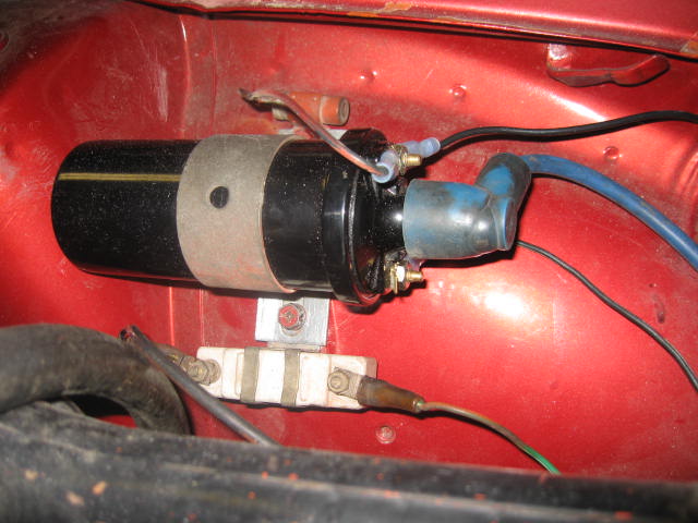

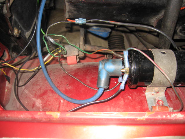

I have tried everything but I cannot get it to start. I attached these pictures to see if someone can tell me what is wrong with my wiring set-up by my coil. My friend moved everything before I could label my wires and it has been a while since we took it apart.
Is there supposed to be a connection fom the resister to the coil?
Thanks for the help in advance

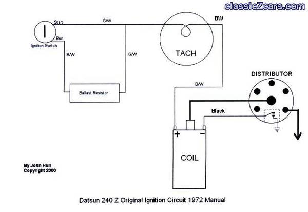

The answer to that is, Not exactly.
See my attached file.
In practice, there is no single, short wire going from the ballast resistor to the coil.
One thing that looks fishy in your photos -- the capacitor deal, up above the coil and mounted to the bracket around the coil -- is wired to the same side of the coil as the wire leading to your distributor.
The capacitor deal should be wired to the + side of the coil. The small wire coming from your distributor should go to the opposite (minus) side of the coil (as in the drawing attached).

I have tested the coil and it is good. I am not getting any spark though?
You aren't getting spark? Well, if the coil tests good, it's time to move further down stream. Looking at your coil to distributor wire, it looks pretty old, I'm guessing you haven't put new plug wires on her in a while?

Second, the original poster states his coil is good, but he does not state that it is producing current or voltage. If in fact his coil is good, if I were the OP, I'd be looking upstream. I would see if any voltage is coming into the coil.
Checking whether the wires run to the right cylinders would be a good first move though -- maybe in fact there is spark -- and it takes no work at all to double-check as to the wires and firing order.
Steve.
Looking at the pictures, and gathering from this and other threads that all the stuff has been hooked up from scratch, my first step would be to use a multi-meter to verify that the wires to the coil and ballast resistor are correct. Especially checking the polarity on the coil itself. If the + and - terminals are reversed on the coil, or mixed up with the ballast resistor wires...
