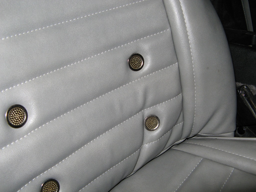

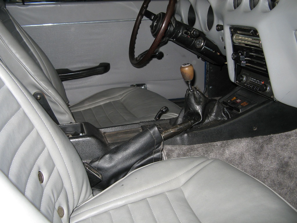

I got my foam and seat covers from DatsunRestore.com I can't really compare the quality to CD but I've heard that Classic Datsun's are closer to the original pattern. In any case, new foam and covers made a huge difference over old seats that are sagging with torn vinyl. I can post pictures of mine if anyone here is interested.
I'd like to see pics... (Please) Prefferably a couple of closer shots of the vinyl pattern/grain.

Here ya go. It's difficult to get a good picture of the grain. Obviously my interior is a non-standard color so that might affect your opinion.
