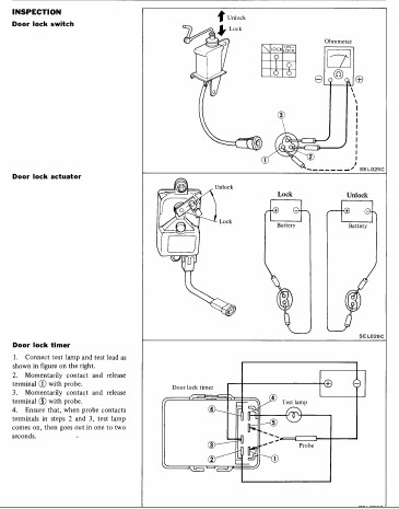

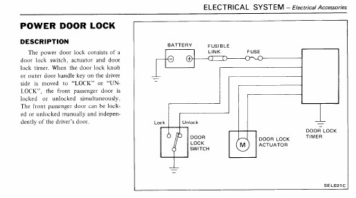

Anyone know the circuitry for the electric door locks. I can't find anything on the circuit diagrams I have been able to locate. This for 81-83 280zx. it appears that there is some kind of latchup relay in the dash someplace cause the switch on driver door pulses current out through two differrent wires depending on lock/unlock. passenger door seems to reverse current when it lock/unlock but only two wires going there. Trying to put electric lock on a 81 w/parts from 83 junker. got the door switches and they work as I hooked them up to my working 83 as a test but not sure of the connecting wiring needed.
