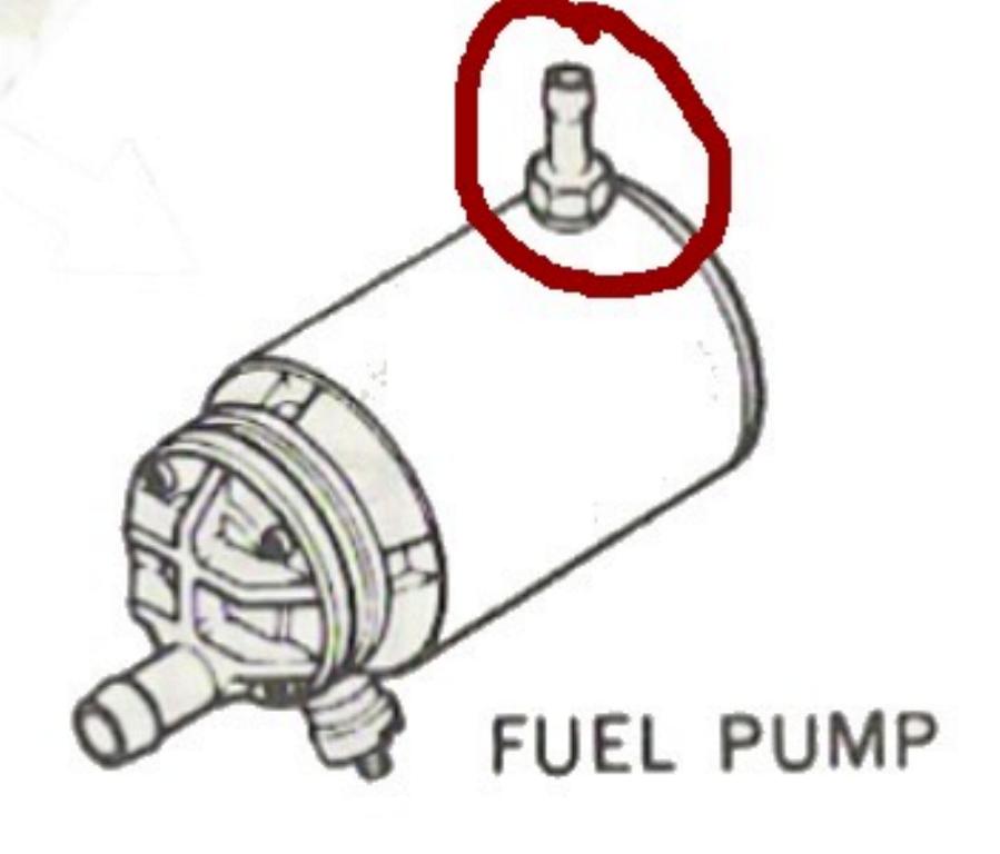

You might want to check the fuel pump check valve since you say the problem happens both cold and warm. A bad check valve would not hold the fuel pressure and each time you crank it, it has to fill up the fuel rail and build up the pressure before it will start.

It still sounds like the check valve to me. I had a similar problem on my 810, same fuel pump, and repacement solved it for me. The part number is 17014-N4225. Don't know if they are still available from the dealer but good ones are easy to find in the junkyard. Just check, by blowing through them, that they only let pressure pass through in one direction. I may even have a good one among my parts if your turns out to be bad.
