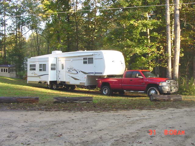

I use my dodge 3500 to pull campers.With different weight numbers all over the truck and campers I tried to find what they all meant and how much could I go over some of the limits.I knew I could pull more than listed.It was finally explained to me like this.Engineers calculate these based on SAFETY.How much a vehicle can safely weigh,haul,and stop based on different conditions.Exceeding these numbers will not necessarily make your wheels fall of but it can void warranties on vehicles,and make you liable if an accident happens. I could be wrong on all of this but it sounded good to me.
