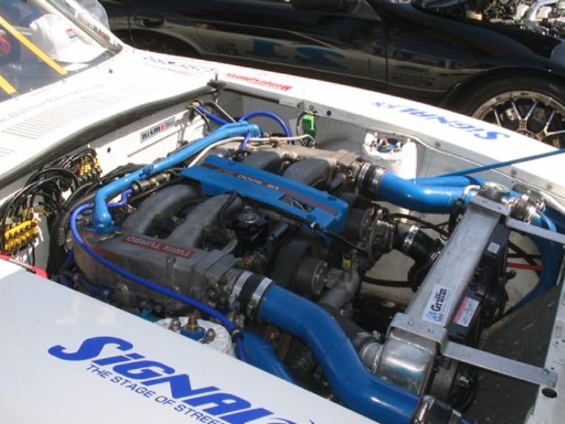

The VG30DETT is just so damned wide that it's a tough swap into an S30 but I have seen it done. Troy of Too Intense Restorations set one up a couple years ago. I don't know if he still owns it or what it cost to build.
Wow, that sure is shoe horned in there!
My wife has an Infiniti J30 with a VG30DE (no turbos:disappoin ). I measured the engine in her car and compared it to my Z engine bay. Even w/o the turbos that engine would not fit without modification. IIRC, besides the top of the motor being too wide the oil pan sump is in the wrong place and the bell housing area is too high and large to fit in the trans tunnel. Not that I really contemplated doing this. I was more just for curiousity sake.
