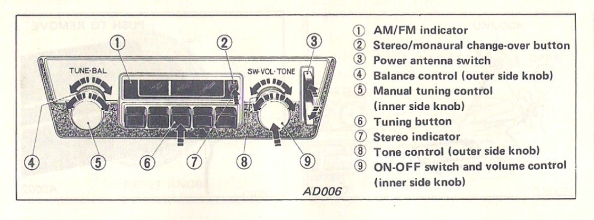

Push the volume control. IIRC that turns it on and off. The one with the up and down arrow raises and lowers the antenna. It's been a while but I once had the original radio and antenna in my 78.
THANKS, STEPHEN. NOW I KNOW WHAT THE SWITCH IS FOR, THOUGH IT DIDN'T WORK. I CAN DO THE ANTENNA MANUALLY, OF COURSE. THE RADIO DOESN'T TURN ALL THE WAY OFF BY PUSHING THE VOLUME BUTTON, BUT IT WAS A GOOD TRY. THANKS FOR REPLYING. I LOVE MY CAR!
JEANNE
It wasn't a 'TRY'. That is the way a 77-78 280Z factory radio works. You push in on the SW-VOL-TONE knob to turn it on and to turn it off. If yours doesn't work that was and it is indeed a factory radio, then something is wrong with it. Try removing the knobs and pushing the shaft. Sometimes the inner knob (which Nissan refers to as 'outer side knob #8) has been installed backwards which prevents the outer knob ('inner side knob' #9) from moving inward when you push it.
